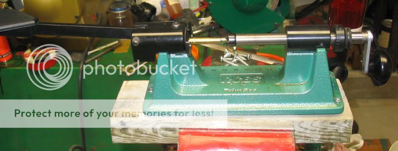

Here's my trimmer set up for .22 Hornet:

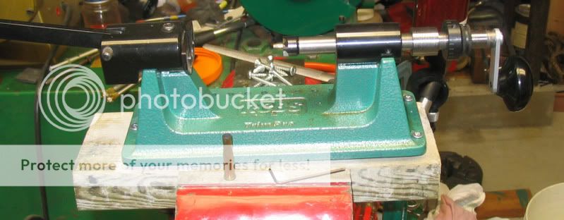

Here it's set up for .45/70. The set-up time is about fifteen seconds.
I just turn off the cutter head, pull out the shaft, slip on the spacer ring and reassemble. Change the shell plate and pilot and I'm ready to go.
The spacers are a twenty minute lathe job and I can make one in just under two hours. (I'm not really swift on a lathe.)
