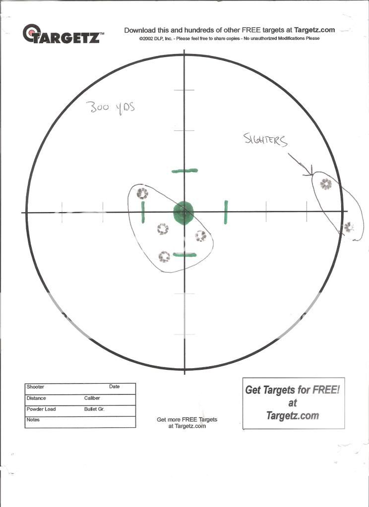

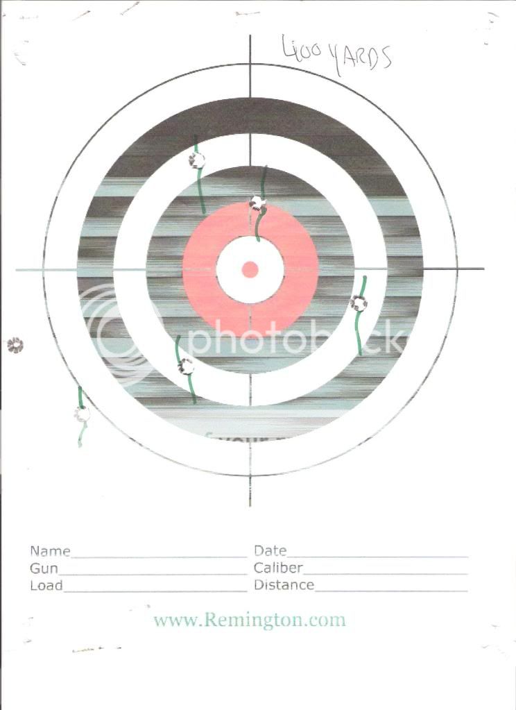

Here are my targets which give the best example of my results.
The 300 yard target I am content with, a little more practice, maybe slight load tweaking.
The 400 yard target , not so happy with.

- Your 300 yard group has four shots in it, your 400 yard group has six shots in it. If you were to have fired two more shots at your 300y group, it would be impossible to make it smaller and likely that it would have gotten a bit bigger. How much bigger would vary from group to group but on average perhaps 30% bigger; so your ~0.5 MOA group might be expected to be .65MOA if it were a six-shot group.
- by eyeball I think your 400 yard group is about 4 inches high by about 5.6" wide (about 1,0 MOA high by 1.4 MOA wide). Especially on a variably-windy day as you describe it is much more meaningful to use a group's height as an indicator of the rifle+ammo+scope+shooter precision; the width of the group is influenced by how good you are as a wind-reader and while this is relevant to how you might place in a match it is not relevant to the question of how precisely you plus your rifle ammo and scope are delivering shots.
So in my opinion what we have here is that you got about 1 MOA at 400y versus about 2/3 MOA (had you fired six shots) at 300 yards.
