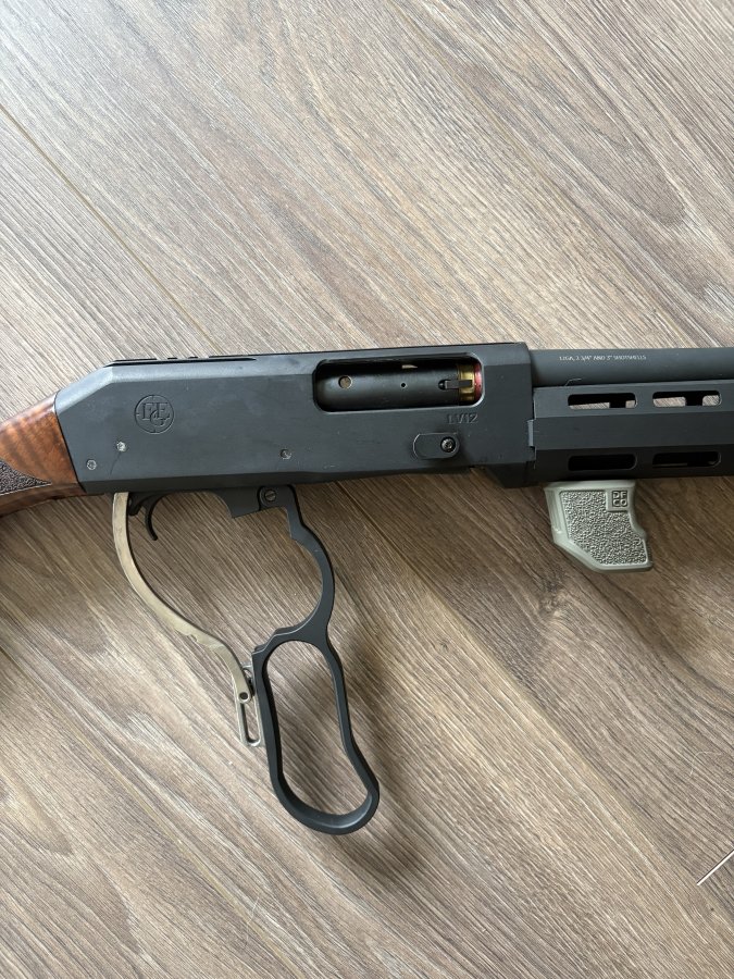

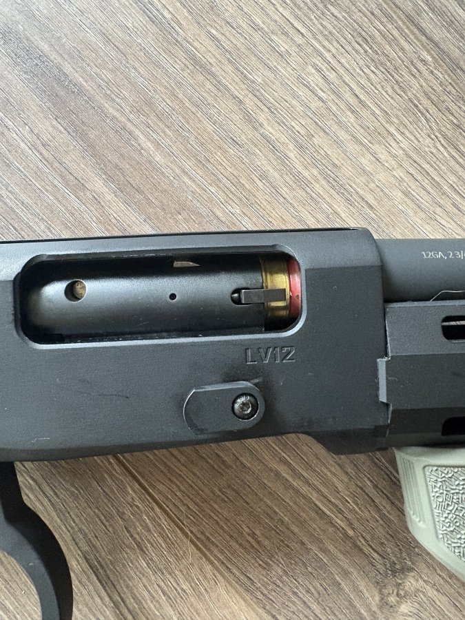

Well got the shotgun back from warranty, ran some snap caps a bunch to function check, then took it for a hike for some small game, fired two rounds to further function check and this happened on the second shot… rod attaching the lever to the bolt has let go and bolt is jammed solid. So it will be packed up again and sent for repair… really not impress. I would avoid.
