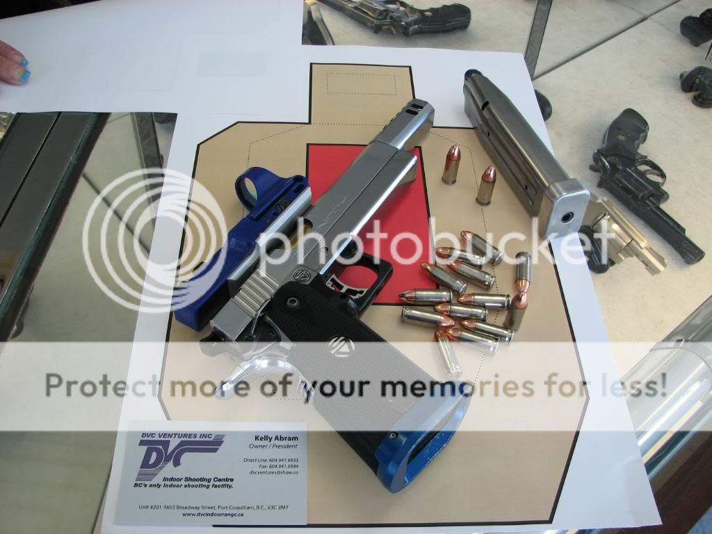

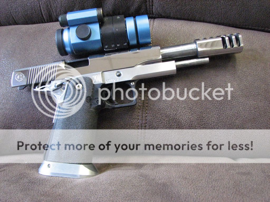

some of my experiments
slide,frame,comp,tail
slide,comp

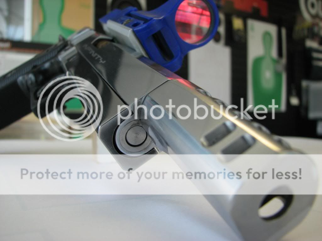

Barrel
the prep work must be flawless cause the chrome deposit carbon copy's any imperfections, everything is done by hand and time
By trade i do hard chrome on hydro rods and bearing surface. Gun slides get tricky.
deposit of material...one thousands of an inch
