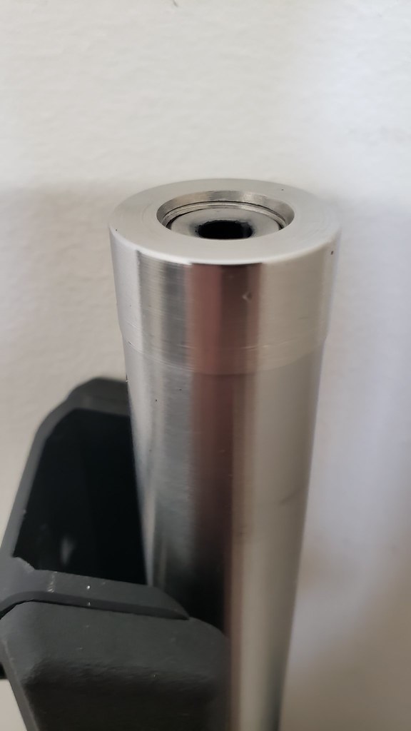

So after my last rainy Outlaw Rimfire PRS match I disassembled and re-assembled my CZ 457 XRS. The only changes I made was the torque value of the chassis bolts from 30 in/lb to 35 in/lb and a new thread protector I made.

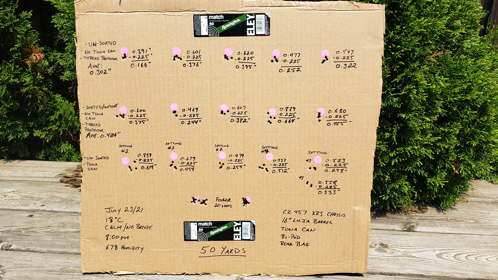

July 23, 2021 @ 8:00 pm till I couldn't see my targets and the wind conditions was perfect... calm, no breeze at all. Disregard the Tuna Can test targets. Test for group size, slow and controlled, no Tuna Can, just the thread protector. Eley/Remington Match Average - 0.363"

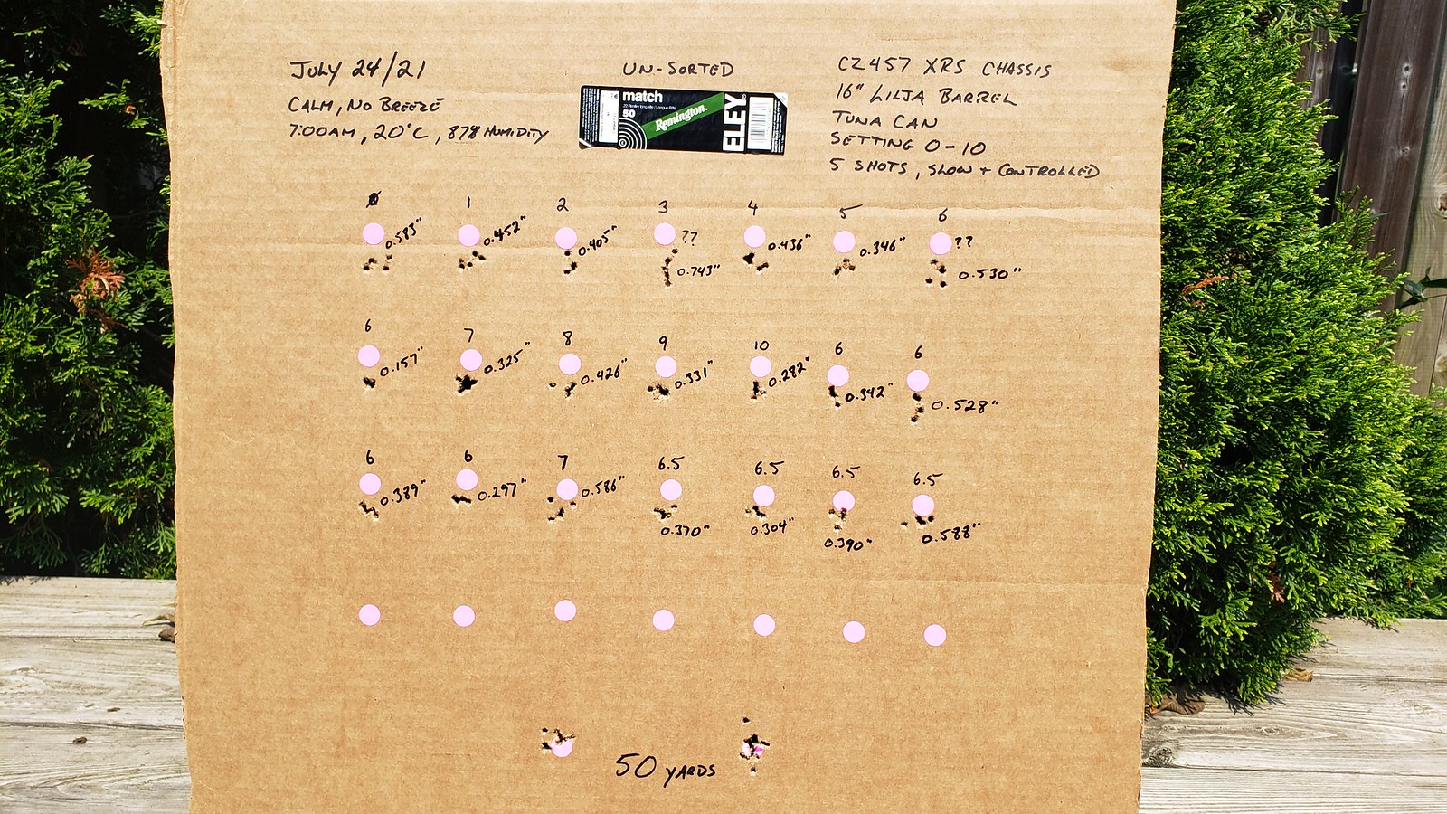

July 24, 2021 @ 7:00 am the conditions was perfect for my Tuna Can testing but come 9:00 am the wind conditions started to pick up and in came the rain and remained that way for the rest of the day. I need to do more testing and create a graph.

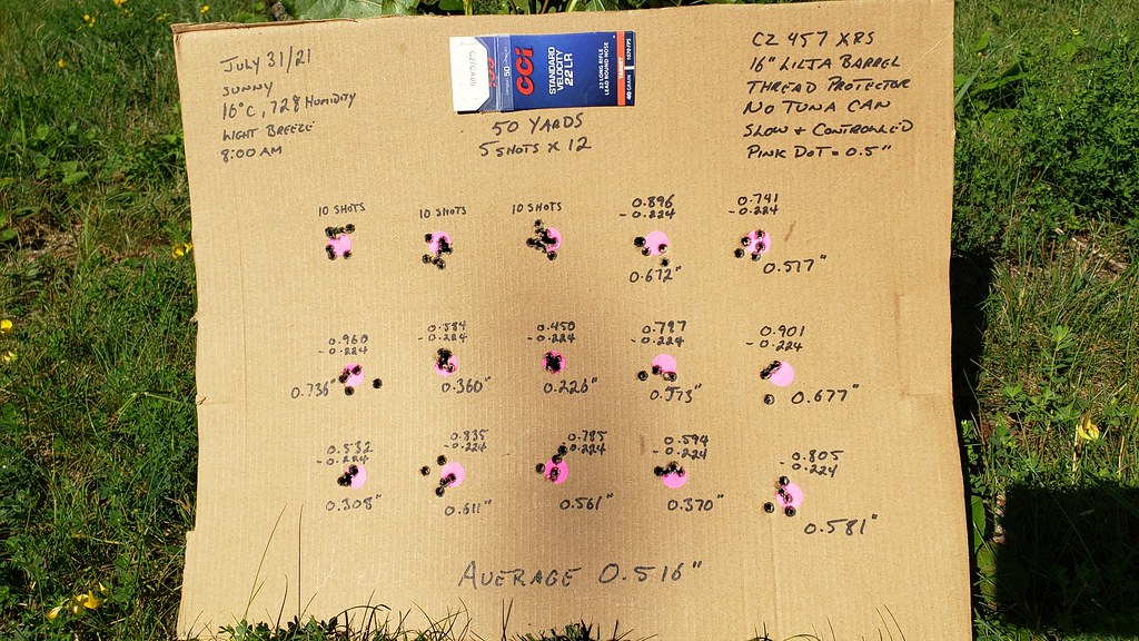

July 25, 2021 @ 6:30 am the conditions was good with a slight breeze. This LOT# CCI SV in the dark blue box surprised me. Disregard the Tuna Can test targets. Test for group size, slow and controlled, no Tuna Can, just the thread protector: Average - 0.349"
So... is it worth the extra cost for this lot # Eley/Remington Match??? The Eley/Remington Match will cost $1689.40 for 5000 rds with an average groups size of 0.363". I bought 5000 rds of these CCI SV in the dark blue box for $610.18 with a average group size of 0.349". For sure I will be saving this LOT of CCI SV for my future Rimfire PRS matches and it looks like I can shoot them without the Tuna Can.

You have 15 out 21 at 1/2" with the eley and 10 outa 17 with cci,my math ain't great but the match is more accurate but at what cost.depends on your funds,if the hangman ain't a calling,buy some eley match.
Don't count the targets involving the Tuna Can, they're in different league of their own. I'm calculating the groups without the barrel tuner.
Eley is 10 x 5 and the CCI is unfortunately 9 x 5.
To be be fair and cherry pick I'll omit the Eley 0.664" group for a 9 x 5 for an average group of 0.330". Not a bad looking average now. But does it warrant a $1079.00 difference for the occasional PRS match? Maybe, maybe not....
