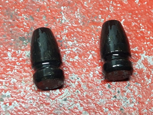

I like the Phantom Glass Black powder. It goes on fairly thick compared to Tool Blue, great if you need to bulk up a mold that throws a little skinny. Sometimes it looks like it doesn't give 100% coverage, but I've found that it's just the pigment that can be a bit splotchy. The base still completely covers.

I love the clear coat, goes on thick and coats very well. Personally i love mixing high gloss black with white 20/80 to 80/20 mixture. if you find a powder doesn't come out coated very well mix it with another colour. in the picture i have different colours i mixed. Black and White, White and Blue, clear. The only colour there that wasn't mixed is the Clear Coat
[url=https://postimg.cc/H8Lx3TBB][/URL]
