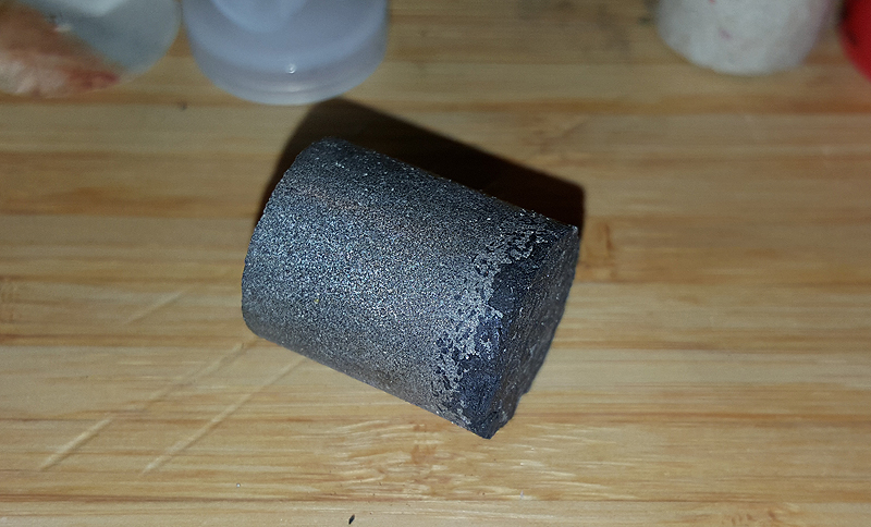

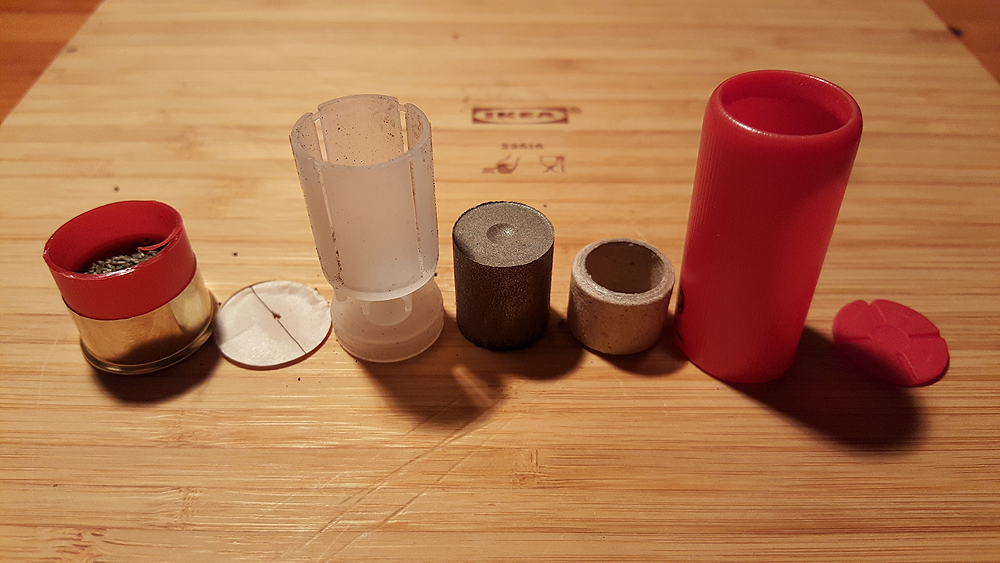

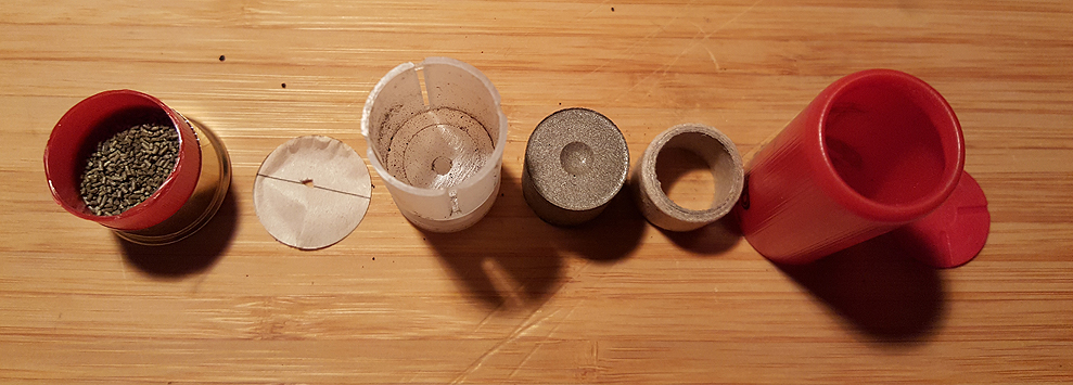

As long as you use a fairly open choke it seems ok, I've fired a few through an open choke 18" barrel, the flare will not fit through a full choke and where a little close for comfort in a mod (i took one apart) The flare is essentially a little rocket, and the magnesium part that is responsible for the glow doesn't light until the rocket motor is used up about 40' out on the little ones. They are dirty as all hell though, and i personally wouldn't use a gun i cared all that much about. Make sure you are disposing of them in a legal manner; we had to call the local police and tell them the time and location we would be getting rid of the expired ones, not sure if this is how you do it everywhere.
