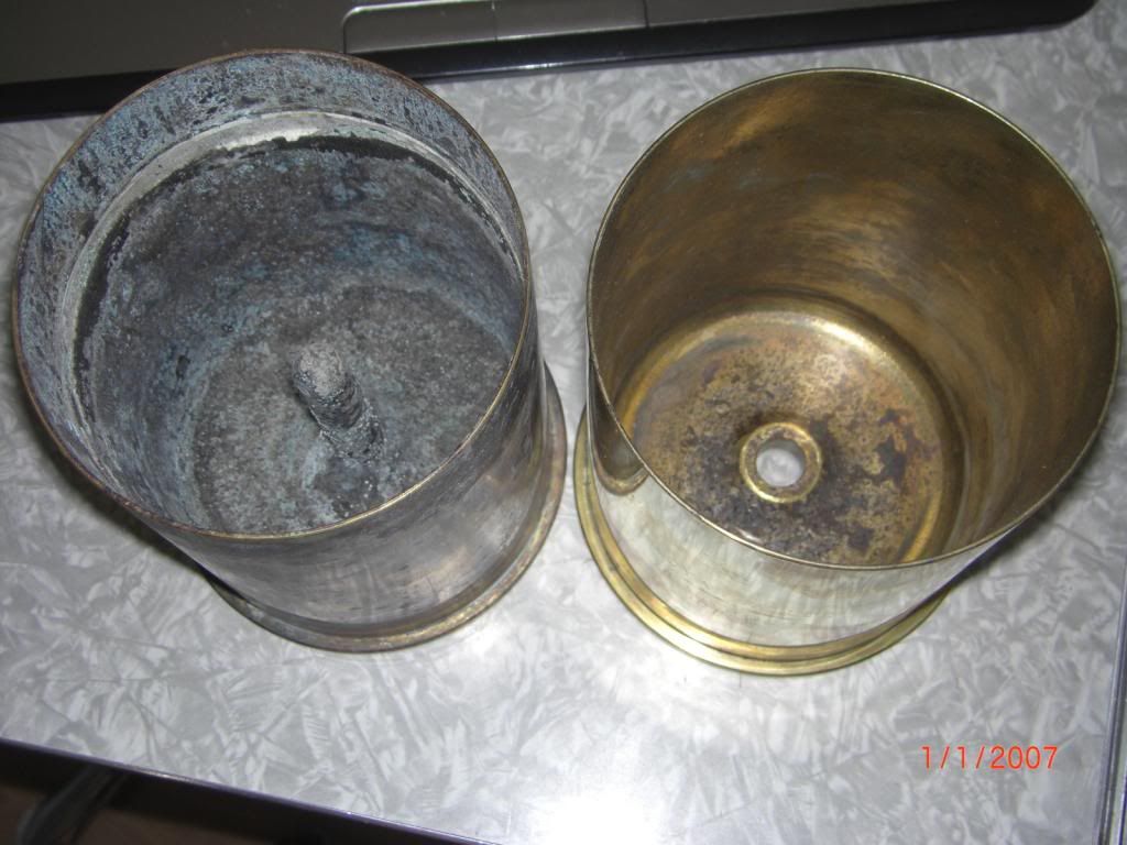

Here's a couple of pics of blank 105mm casings. They're the same, just 1/3 of the length
The 1st casing is fired. 2nd one has been cleaned and shined up for an "award".
The rod is threaded into the casing

I have two of these shells one with the primer in and a fully polished with it out. The polished one is smooth not threaded and the dirty one has no way to screw out the existing primer. It seems they are pressed in. I have a buddy who is an ammo tech I will give him a shout and find out how to extract the primer.

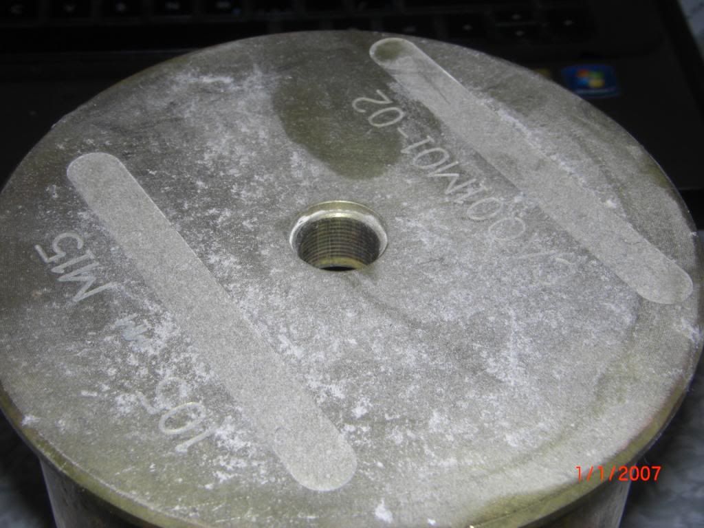

Very interesting! I have 1972 dated 105 casing that is full length brass, once fired (do they reload these?) and has a long flash tube in it. With a flash light you can see it is perforated. I gently put some vice grips to it but it's in there pretty solid and doesn't feel like it wants to turn.
hard to turn a tube inside a tube, especially considering most cases start as a flat sheet.
like this only bigger, the case is then drilled/tapped for the flash tube, this causes a better burn pattern increasing pressure curve, and reducing SD's
You're right, turning the tube inside a tube is the trick! I can get on the end of the flash tube with a set of vice grips but I didn't want to risk squishing it so wasn't able to grab it tight enough to turn in either direction without the vice grips starting to slip. The holes in the flash tube seem to be drilled clean right through both sides so I may be able to put a 2" or 3" nail through the flash tube and use that to torque on. I'd like to be able to disassemble this casing slightly but if it's not meant to be, oh well. Makes a great door stop either way!
