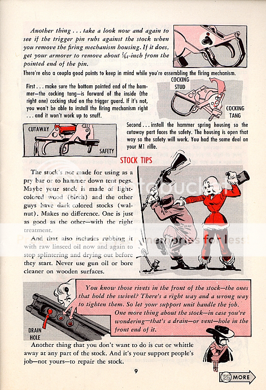

I STILL have yet to understand how it vents any gas? The gas is dumped out of the hole in the bottom of the gas cylinder, below the valve. No gas comes blasting out of that hole... The stock I got from The old Doc' has a sling stud where that hole usualy is.
It does NOT vent any gas. Ever. Its only purpose is to drain water. Don't be afraid to plug it, unless your operating in monsoon conditions.
As you can see all the gas exits through the bottom of the gas system, where the gas release hole is. Not in the stock.
too funny.......
it's for venting gas LOL
and i suppose water should it get in there
the reason it is there for the gas, is that those gasses , if trapped and allowed to settle inside the stock, collect on the surfaces of the rifle and cause pitting/rust ect. primarily right above the piston on the barrel and the oprod tube.
i've got a video showing it very clearly and i'll see if i can post a link.
actually nevermind the video i was going to post, it has our advertising on it so i'll get banned LOL
but seriously, get a file, set the sling plate back the distance of 1 hole. reattach your sling plate with 1/4 x 28 button heads and nuts and attach your stud to what was the front sling plate hole.
It is the "new" way to go for those that want a bipod on a stud, not block the hole, and keep the standard sling plate.

The US military put it on every single M-14 stock it own's for a reason.
I don't know why it's there but it is there for some reason.
