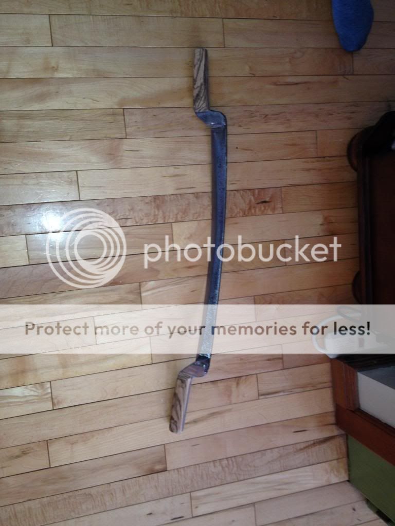

Actually on a sidetrack, i thought it would be neat to make a draw knife for fleshing, I made this out of some leaf spring some steel welded to it and some of the left over zebra wood in the garage on a saturday, then I bought the book deerskin from buckskins and found out its totally the wrong shape. Ill probably try something better when I have time again.

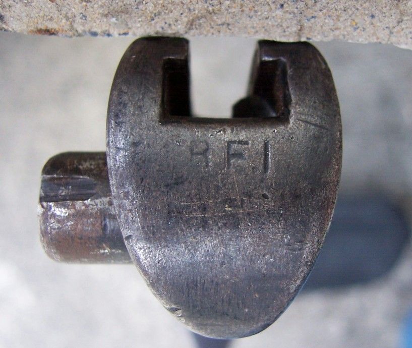

Thanks for the link, BTW, are the ones stamped RFI reproductions? I see some $70 jungle carbine bayonets on amazon.com and from what Ive heard they go for $200+ these days.
These are original. India cut down No. 1 Mk. 3 bayonets to a shorter length for there Ishapore 2A1's (a 7.62 Nato No. 1 Mk. 3) as in the 60's (when they were produced) they realized they didn't need such a long bayonet. RFI is Rifle Factory Ishapore (originally GRI, name changed when India became its own country), I believe they were all stamped RFI on them when they were cut down. Mine was a cut down 1942(or 1943 stampings are not that clear) GRI but it also has the RFI stamping on it. I don't know anything about the Jungle Carbine bayonets besides unless you know what to look for avoid them as they are faked often (like the Jungle carbine itself).

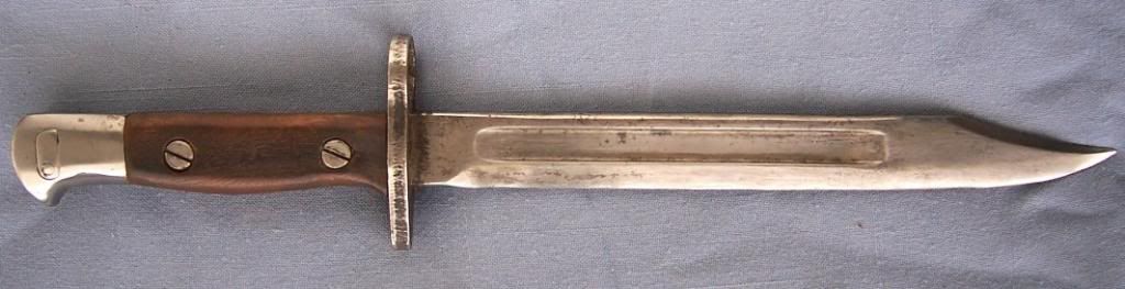

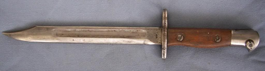

India did cut down some Pattern 1907 long bayonets, but the majority of what I have come across were made as short bayonets (Mk II, Mk II*, and Mk III if I recall correctly). Many will not have the RFI stamp as they were made in different plants. One of mine, for example, is marked MIL for Metal Industries, Lahore. Most of the short models don't have the "blood groove" on the blade either, and some have a squared off pommel.

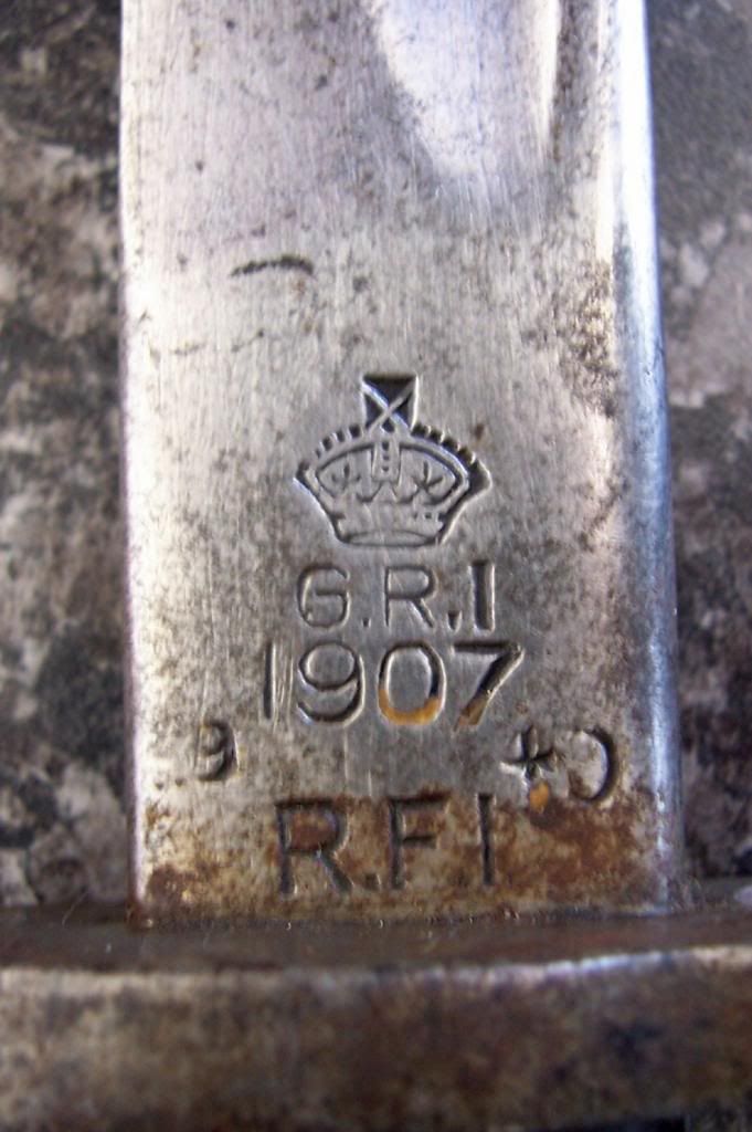

Let's clarify that lest someone mistakes your meaning and thinks the factory was ever called GRI. It was Rifle Factory Ishapore before independence, too, but the pre-independence rifles were stamped with the cipher GRI because they were made during the reign of King George V or King George VI. GRI is the initials for George, Rex-Imperator, i.e. George, King-Emperor (King of Great Britain, Emperor of India.)

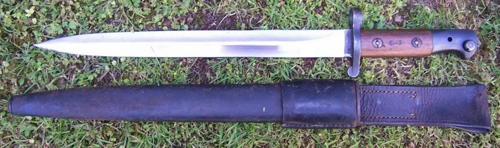

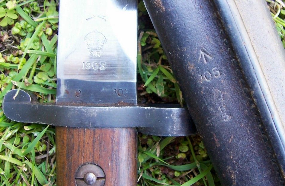

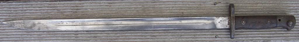

There are also the Patterns 1888/03 and the 1903.
If anybody chops one of those, I swear I will cry!
Beautiful pieces and SO very hard to find. Cost a ton of money and STILL underpriced when you consider rarity.
Thanks for the excellent photos, 5THBATT!
Lovely pieces.

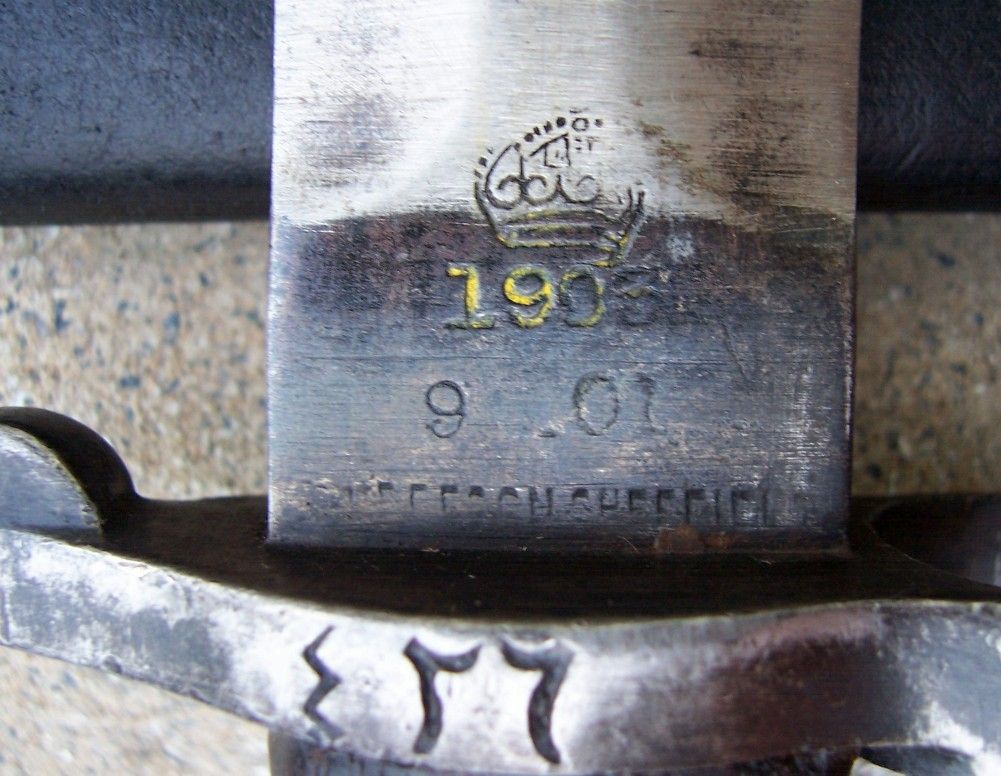

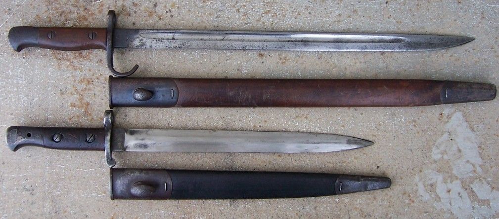

I note with much drooling that you also have the 1907 original model ("Japanese Model") with the hooked quillion. I have one also, marked to the Rifle Brigade, but it looks like garbage compared to yours: appears to have been underground for an extended period.
Thanks for the clarification. Sorry to all if the intent of my posting was unclear.
Smellie, i dont have that '07 anymore, swapped it for a full numbers matching 1901 MLE Mk1* with the guy i actually got the '07 from but i do still have my 1908 dated hookie.
That '07 (EFD '10) i was with the guy when he first picked it up, he was told by the seller it was picked up off a beach at Gallipoli by the guy that he got it from, he gave my mate the name of the guy & it checked out as someone who was at Gallipoli, so the story had some merit but at the end of the day just a story........
