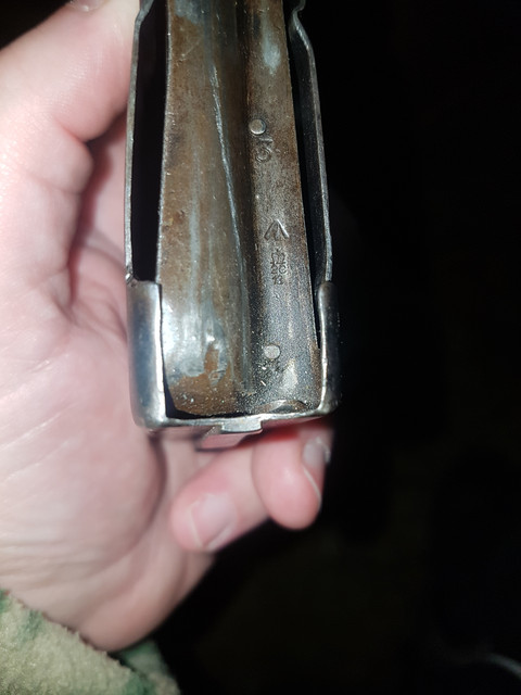

OP - the markings that you are showing are on the follower within the magazine - so far as I know the ID markings for the magazine box are on the rear face of the box - where that latching step is. Followers, springs, etc. can be swapped one magazine box to another, so the markings on the follower may or may not go with the origin of the magazine box. The "Broad Arrow" that you show would normally indicate British ownership - Canada used similar Broad Arrow, but with a capital "C" mostly around it.
In the very first picture that you posted, is not slam dunk certain to me that what you have there isn't actually a No. 1 magazine (from an SMLE) - they can be modified with grinding, etc. to be "made to work" in the No. 4 rifle that you have. You would see the evidence of that on the rear end of the magazine box - there were a number of "bumps" and "steps" that had to be ground off.

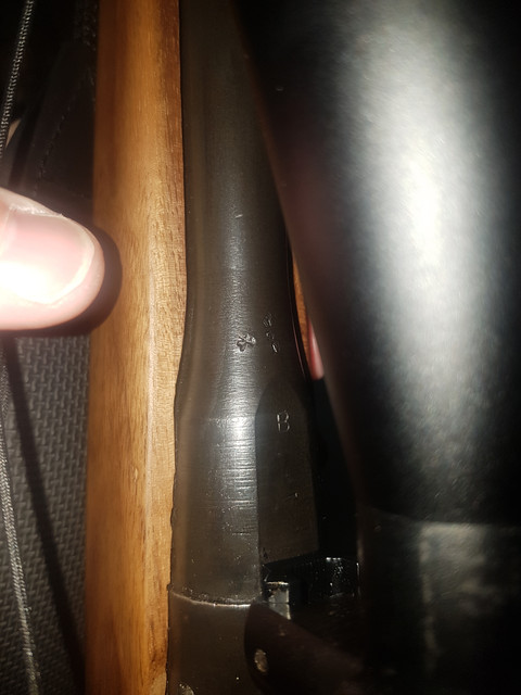

Ok. I asked a technical question which a Lee Enfield "person" would understand. Have you taken the rifle apart? If you did, was the trigger attached to the guard with a cross pin? Or, was it hanging from the bottom of the receiver? The second is what is called a hung trigger, and one of those things the British did late in the production history, which they should have done in 1939. But they were preoccupied with just a few other matters at the time.
I don't think he has a clue about what you're asking. Just look at his next question about the magazine in his hand with "military property" stamps in full view.
