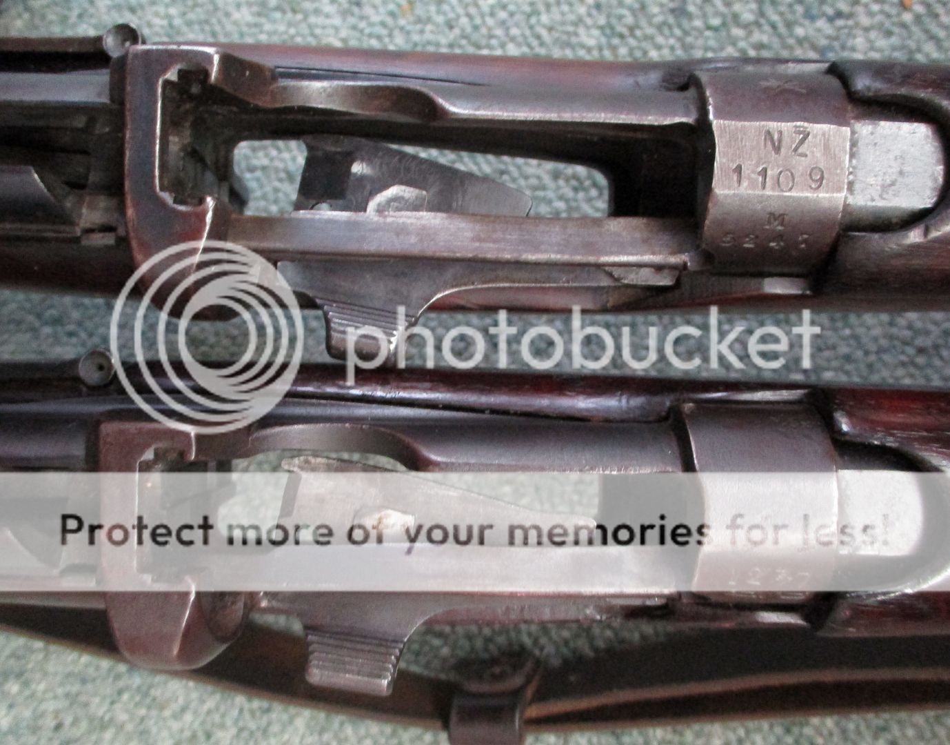

I think you have a cutoff for a Long Lee. The early cutoff will interfere with the front lips of the mag (but usually not enough to prevent use) and the proper cutoff for a No 1 will not interfere since it is narrower at the front to clear the lips. Could you post a photo of your cutoff? I have a spare correct No 1 cutoff and would be happy to exchange cutoffs with you. PM me if I can help.

I'll try to pull it out tonite and post a pic. From description maybe I do have a long lee cut off. It covers the front lip in closed position.

You don't have to pull it at this point. Remove the mag, open the bolt, close the cutoff and take a photo from the top looking down at the cutoff. That should give us all the info we need.
Yes, the Long Lee cutoff is different in that the later version of cutoff has a deeper cutout from the hinge screw/hole before the metal gets wider. That cutout area allows it to be used in all the mags subsequent to the early versions. I have a few extra - I can trade if you wish.

2 MkIIIs, top one has a MkIII cutoff, bottom has a Long Lee cutoff.
Strange turn of events boys,
When I inherited the Metford it had what now appears to be a cutoff for a later model Enfield like 5THBATT posted, as well as an improper mag. I managed to get a proper mag but never realized the cutoff was wrong for the mag till just now.
Looks like I do indeed have a long Lee cut off tucked into Grandads gun.
