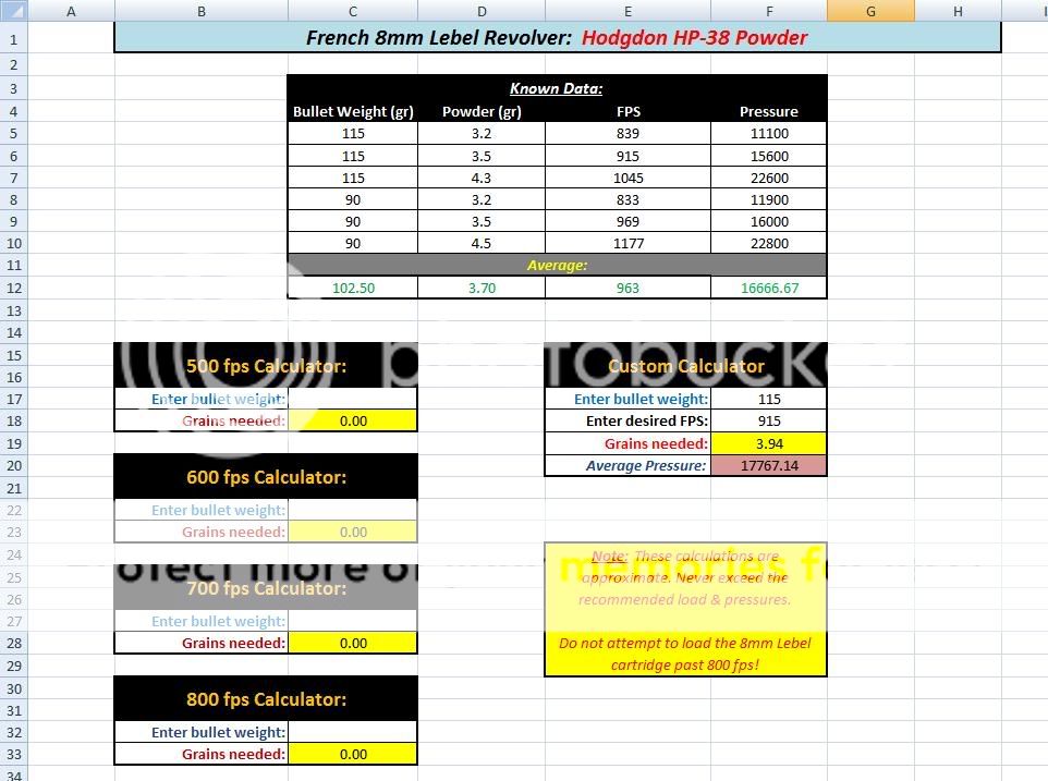

Edit: A fellow member in the Aniques forum where I posted originally regarding the same topic was kind enough to give me some HP-38 data from the Hogdon reference list (loads are for the 32-20, which is nearly identical). With that data I was able to construct a load calculator, which I've put up for your download/testing on rapidshare (max 10 downloads):
ht tp://rapidshare.com/files/250498131/Load_Calculator_-_HP-38.xls.html
(You have to enter your bullet weight/desired FPS in the "Custom Calculator" to see it in action... I have it set for 110 gr and 600 FPS, but you can put other numbers in there).
The fun thing about this calculator is that in theory it can calculate loads & pressures for any caliber, as long as you fill out the 'known data' table with known numbers - but you have to be careful not to erase the math formulas contained in other cells though! (it's a Ms Office Excel/Open Office Calc file). Let me know what you think... personally, I think this should work.. at least in theory. ;)

Intersting. Can you please tell us more? What theory is it based on, i.e. how did you develop the formulas?
Well, it's quite simple, really... it's all math and a legacy of the statistics class I've taken recently in my university program - and aced it big time, lol (we had to use Ms Excel every step of the way). I figured that, if you use one single type of powder for the calculations, then bullet weight, powder quantity and FPS MUST be directly related - kind of like the fire triangle (can't have fire if you don't have all 3 components - heat, fuel and oxygen).
So, I basically entered all the known data in a table and did averages for each (bullet weight, FPS and powder grains - pressure was added too at this stage, but I wouldn't rely on that too much, as the averages tend to be unreliable with such big differences in numbers- ie. 9300 cup vs 22600 cup with a little powder variaton, etc).
So, in a nutshell, I decided to have the formula take into account the desired bullet weight and FPS in order to calculate, based on the averages of real data, what the theoretical amount of powder SHOULD be. Of course it is not an exact science, but if we suppose that powder amount, bullet weight and FPS are directly related to one another in the known data charts, then the calculator should give you a very good basic idea of where to start when you want to reach a target FPS in your reloads - for the same caliber and with the same powder, of course!
I plan on buying myself a chrony and measure FPS of my reloads, then develop this further - I am 100% positive that with enough 'known data' for the real 8mm Lebel (or any other caliber), this calculator can be 99.9% accurate every time.
The weak link (in its' inaccuracy) truly is insufficient data... the more know data is entered, the more accurate the averages, thus the more accurate the calculator. For now it tends to be the most accurate in the median range - at about 900 FPS or so. Try it and see for yourself, you'll know what I mean. The formulas are not hidden, so you can actually see them in Excel's formula bar.
P.S. I've built this because I've got peed off at the insufficient info on the net regarding the 8mm Lebel revolver cartridge and its' reload data. And so I've decided to take whatever little info was out there (most of it was for the 32-20 anyway) and build this. Like I said, once I have my chrony and some time to go to the range to collect tons of data, I'll make this into a very reliable calc... for now it's still in the testing stages though. The 8mm Lebel revolver round shall live again! ;)

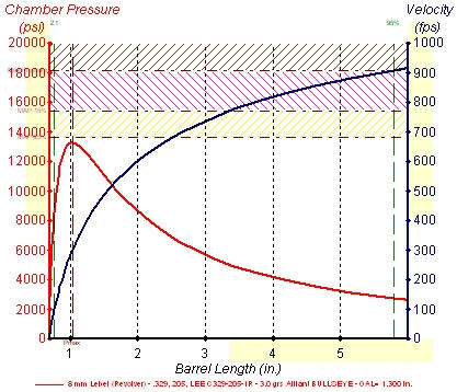

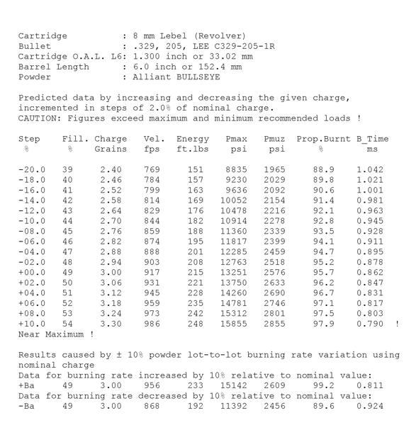

You should check out QuickLoad. It is an interior ballistics program. There is a very limited demo, but it includes the User Manual in PDF. The Appendices in the back of the Manual will really give you a good eye opener into what is involved in calculating interior ballistics.
One thing you will find is that the OAL (specifically the volume in the cartridge below the bullet) makes a HUGE difference in the peak pressure.
Here is a sample output from QuickLoad. It is based on an arbitrary 115gr bullet that is 0.6" long, and a bullet OAL of 1.30" and not the Lee 205 grain listed in the table below (The Lee bullet is in the program's database, but I manually changed this Lee bullet into a 115gr but it didn't reflect in the label in the output below. I should have actually created a new bullet.)
This is just a SAMPLE based on the assumed parameters above. Shorten the OAL and pressures WILL increase, or if the bullet length is longer than my assumption, pressures will be higher.
A sensitivity analysis changing only the OAL will show huge differences in pressure for seemingly minor changes in case volume.
