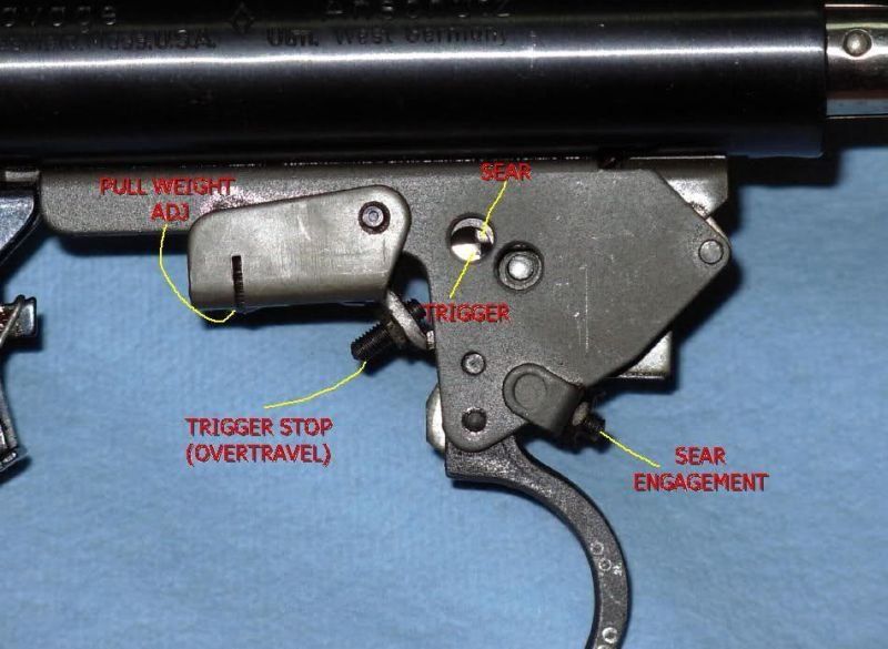

You should be able to achieve good results with a CIL Anschutz 180 or 190. The 190 will be more front rest friendly as it's stock is a little flatter, and perhaps a little wider. If you're using a bipod and rear rest, you should be able to get good results also. The trigger is likely the same (the 5057) on both rifles, depending on year of manufacture. The trigger pull will probably be around three pounds and there's not much that can be done to make it much less. But it breaks cleanly and is quite shootable.

There's only so much adjustment for pull weight that can be achieved with the 5057 trigger in the 180.

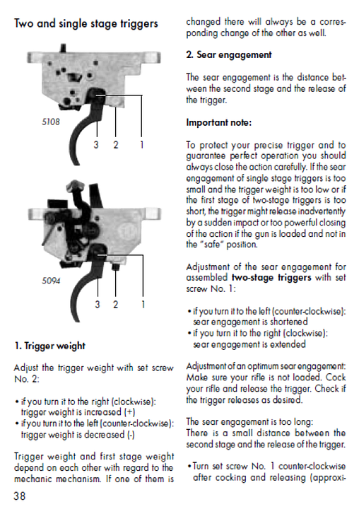

Unless it's a model from the the mid-70s it's probably the same trigger in the 190 also. CIL Anschutz 190 rifles from about 1977 had a 5094 trigger.
Below, the 5057 single stage trigger.
Below, the 5094 trigger.
Both triggers are 5057, so I should be able to get the 180 as good as the 190. I will be happy with that. My shooting will be limited to 100 yds, more frequently at 50 yds. Being as I am the current weak link here, I will try to get more trigger time before I continue testing, and I have seen the Tesro variety pacs. I will probably go there once I have honed my skills a bit. I see no sense spraying quality ammo due to my lack of practice. Thanks again for all the input.
