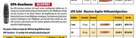

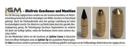

A number of makers used them as a simple design more so than anything these days. They used to be seen as a way by some makers to put the most mass in the shortest bullet, and then ensuring a larger wound channel as they are (if built properly) supposed to mushroom a bit while still plowing through. If you check out a number of the Euro makers they will recommend a 308 180spire or rn for the same class of game, just tell you the old round nose design will make a wider and longer wound cavity.
Honestly S&B is about on par with cheap Win/Fed/Remmy, and the Euros have tons of factory loaded stuff with Speer, Nosler, Barnes etc, and of course the old Euro designs, to a point I would say they have more options usually than we do.Capture.JPGCapture2.JPGCapture3.JPG
