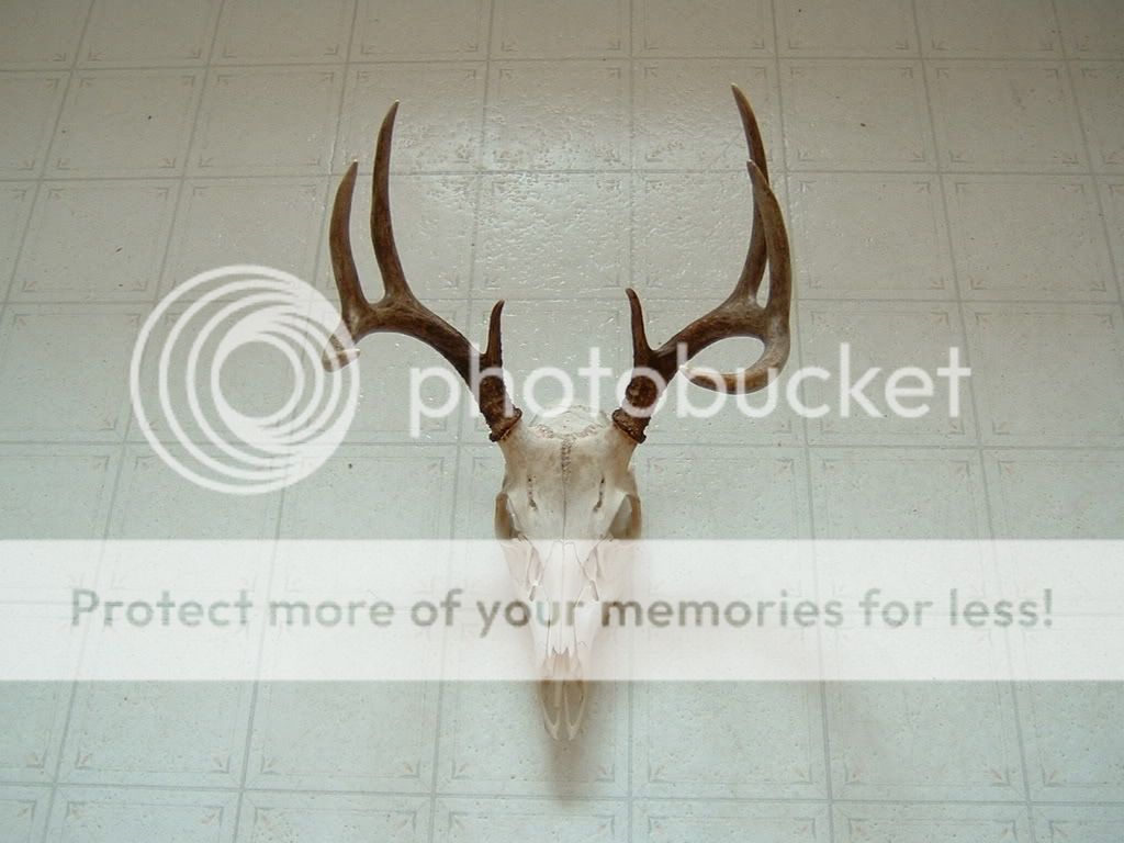

This is mine from this year.
First go at a Euro.
The picture on the counter, is still wet from the stove. The one on the floor, is a while later.
This was a straight-up, hot water only job. I did not have a pot that would fit him, so he spent most of a weekend, sitting on the stovetop in a roasting pan, with water up to the base of his antlers.
Pretty pleased with the way it turned out. For a first effort, really happy!
I blew out a tiny bit of the sinus bones while poking at some of the loose material in there, but otherwise it turned out great.
Maybe spent too long on the stove, as some of the seams started to get a little loose, too.
Gotta come up with a base to put it on, now.
Cheers
Trev
Nothing added to the water.
Heard of soda ash, and heard of using hairdressing peroxide, as well as bleach.
I didn't want to go to the trouble until the skull was clean, and I like the way it turned out, so this is how it stays.
There was a bit of dish soap on the brush that I was using to fish around inside the skull and sinuses with, and a little of that ended up in the pot, but it really was as easy as boiling water.
The skull is pretty nice and evenly white (ish) as seen, but there are some grease stains on the lower jaws, after they dried. From the bone marrow, I expect.
I skinned the head, removed the eyes from the sockets, and trimmed away as much material as I could get from around the jaws, and just let it cook. After a couple hours, I had at it with the knife and trimmed a bunch more. Scoring the remaining flesh on the roof of teh mouth, and across the skull helped, too.
Mostly just patience and time.
Cheers
Trev
