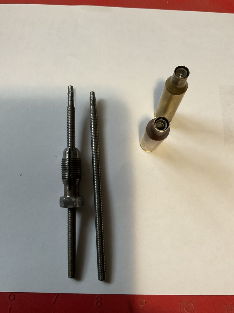

What am I doing wrong.
The expander on my die keeps getting stuck in the throat of the casing and the thread fails.
1. I lube the outside of the case.
2. I resized 7 casing before encountering this problem
3. These are from hornady dies.
4. I remove the de priming pins since I have a universal de priming die.
Seeking advice.
Thanks
IMG_0508 by fljp, on Flickr
I have never experienced that - with using several brands of dies - from your picture, it looks like the threads on the stem are very flat top - not like "V" threads at all - would not have much bite to a female thread?? Is my only guess - no experience with that at all.
Stripped threads where the expander ball goes? That is the only thing I can think of (and at least to my eye it looks like the first few threads are damaged?), I'd expect that you would destroy the brass before you strip the threads on the die though?
The threads on the main stem look weird, but they match what I'm seeing on pictures of Hornady dies, it appears to part of their "Zip spindle" design: https://www.hornady.com/reloading/dies/custom-grade-dies#!/

Yes, a tiny bit of lube works wonders on the inside of the neck. One other thought... you said that you removed the decapping pin , is the rod slotted where the pin goes in? If so ,perhaps the jaws are compressing a bit without the pin in place, resulting in a slightly smaller diameter on the threads.Maybe try with the pin back in place,and some lube. Just scratching my head. ....catnip
Had that happen recently with Lee 300 Savage FL die, not much room for error with that one, pin has to be flush with the nut, or the expander is sitting at the neck junction and crushes the neck.
Update: Hornady is sending me two new spindle, expander and pins … sent the. The pics and they said send us you address and replacement will be shipped

If it were me, I'd leave the decapping pin in place. It may support the inside of the rod so it can't collapse, if that's what's happened. If the primer is already out, the pin is just along for the ride anyway, it won't hurt anything.
I'm familiar with the flattened thread crests on the Hornady decapping/expander rods. I think they're designed to slip if something isn't right, like the ball being set too low and hitting the inside of the case. Lee does something similar with the tapered friction bushing that holds the decapper/expander rod.
But, I thought the Hornady ones only had the modified thread on the upper part of the rod where the depth adjustment is? Yours might have been defective.
Finally, be sure you have the height set correctly. On a short case like the 223 or 222 it's critical since there isn't much room in the case to work with. If the ball is too high, it's possible to have the ball in the neck while it's still squeezed down by the die. That's going to be bad news, you'll have compression and expansion trying to happen at the same time.
You should be able to see and feel the case start to come out of the die by at least the length of the neck itself, BEFORE you feel the added resistance of the expander ball pulling back through the neck on the out stroke.

The nut on the depriming/neck expanding rod has to be tight. Very very tight. Ask me how I know. I mean tight...
Or this happens,
it looks like your expander is adjusted too high and your trying to size the outside of the neck and expand the neck at the same time
It it gets stuck enough you can tear the neck off, but usually the rim is torn out of the shell holder first. Then the fun starts trying to salvage something.
