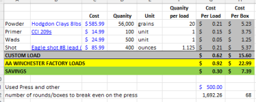

OP - Looking at your costing, I note that:
1) Your primer pricing is high - Cheddite can be had for ~ 80$/1000
2) Lead can be had for ~65$/bag.
A lot of this pricing is location dependent. Here in Southern Ontario, a fella has access to some major suppliers/manufacturers. Additionally, you can buy flats of Federal or Challenger for ~ 110$. Dont bother making a comparison to AA's, they aren't worth the premium.
used to reload alot I have a lee load all in 16 ga and 20 ga and will get a 28ga when available here in Canada as well a mec jr in 12 .Lee are great for low volume reloading but if your gonna reload lets say a flat a week or month then invest in the mec line.Cost wise I dont think your saving much if anything doing 12 ga anymore 16 and 28 410 it still pays to reload cost wise and availability.20 ga I still reload I never seem to get the good deals on flats of those so just load them.It helps that I can drive to hummason to buy shot.
Are you sure about these numbers? Shot is the most expensive component, so why does your 1/2oz .410 save only $1.40 compared to a 1oz 12ga? And why would a 7/8oz 20ga cost more than a 1oz 12ga? There is less shot, and the wad cost should be the same. It will use a different powder, but they are mostly priced similarly.
Numbers are correct, but I could have also stated any cost of a hull is not included. Powders are not priced similarly nor are they all using the same grains per load. Perfect Pattern is, relatively, a very inexpensive powder and also a very efficient powder by grains/load for 12ga 7/8 and 1 oz loads.

Where would you be purchasing flats of 12 gauge for $110?? Thanks this is good news
Locally, the trap shooters will buy their shells in bulk through a club group purchase. From what I have heard (I don't shoot any shotguns now), the cost of factory shells negates any cost savings for them. Finding shot locally is near impossible so there is alot of extra cost is sourcing and shipping.

12ga and 20ga are not really worth the time and effort when you can buy flats of cheap ammo for about $130/flat. Now if you want to shoot say 7/8 oz or 3/4 oz 12 gauge loads then it is worth your time and effort.
The big savings on loading shotgun ammo is when you are loading 16 ga, 28 ga and .410.

I am going to let you in on a secret. Skeet Trap and Sporting Clays is every bit as expensive as rifle shooting 😬. I am speaking from the experience of shooting sporting clays near 20 years . At one time a fellow could load shells on pare or maybe save a couple bucks on bulk ammo price . And have the satisfaction of breaking targets with ammo you made yourself. Now days there is no savings in 12 and 20 gauge . Here locally a bag of shot is 85 bucks plus the taxes . For an other 40 bucks I can buy a flat of shells (250 rounds). My advice is go the bulk ammo route . If your not loading for sub gauge guns .
