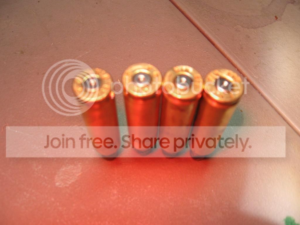

Fail to fire 243 win
Smacking a primer with a hammer isn't much of a test whether it should ignite with a firing pin strike. There's quite a difference between a precise pinpoint strike directed to a lightly stressed against a preloaded anvil and crushing it to oblivion with a 3 pound hammer.
I had a a batch of 1000 Wolf primers that were no good (50% FTF) and I just bashed them with a hammer to get rid of them. By the way I've tried neutralizing primers with oil and even ones soaked in Kroil for 24 hours would sometimes still be live.
And what would be the problem with this if its only the primer??? I've done it many times, Difference of opinion I guess.
