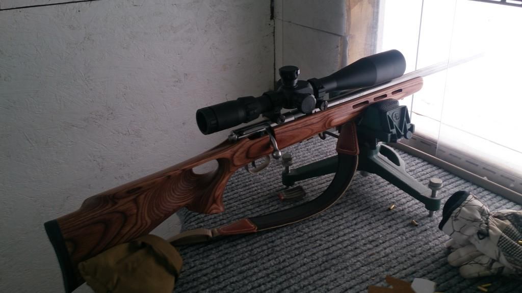

This is a second hand "new to me" scope. I have it mounted on a 22 lr Savage Mk II BTVS with the EGW 20 MOA base.

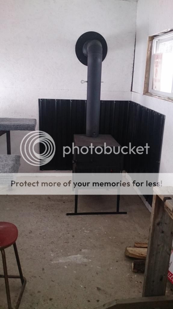

Now I went out today and after discovering a new wood stove in our covered rifle range, I started a fire and got it to the temperature that you did not need a coat or gloves.

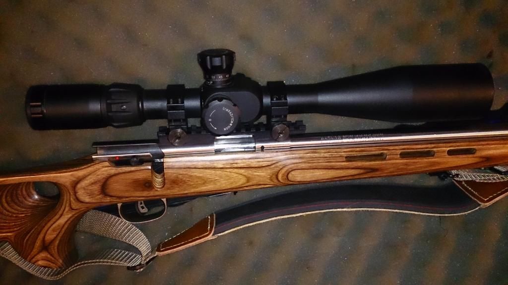

The beast of a scope:

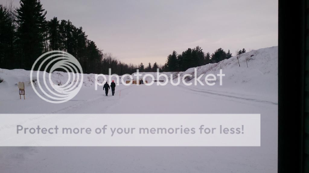

The range today after cease fire. 92 meter stand in foreground 184m stadn in background.

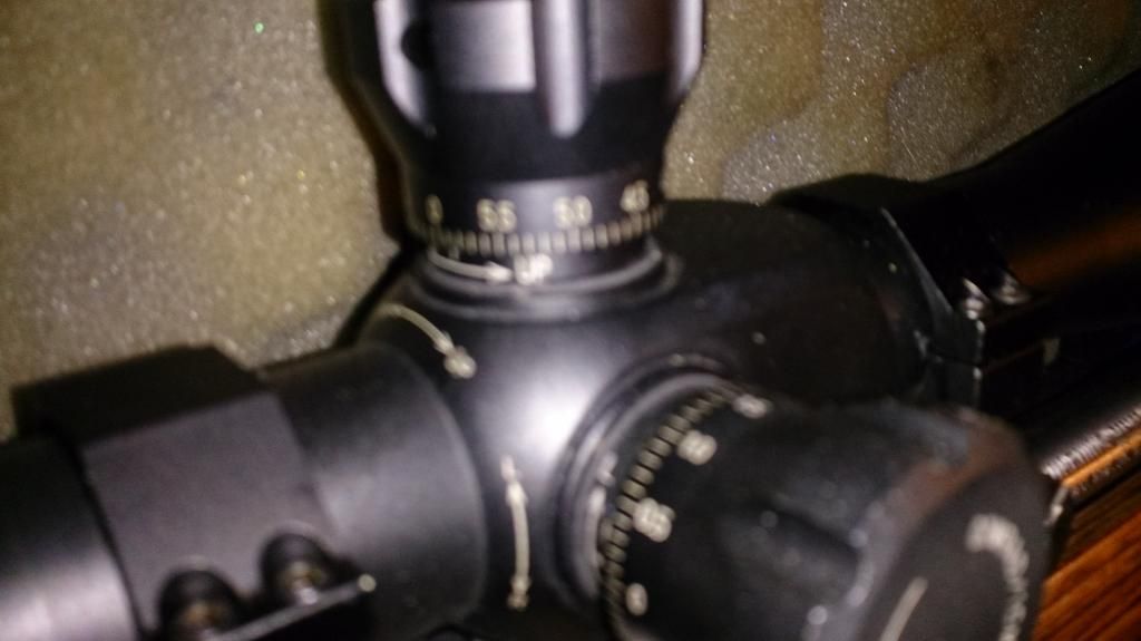

A fuzzy picture of the scope turrets:
