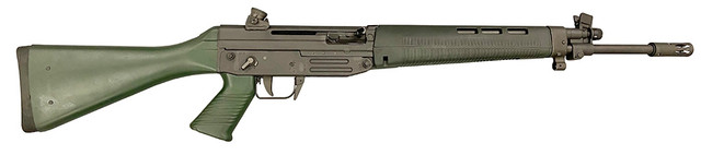

FAMAE 540 FAQ: Why it’s cool, and you should own one.
Background / History

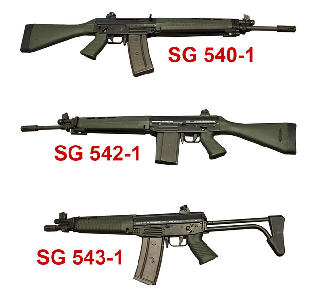

The Sig 540 rifle has a long-stroke piston, gas-operated, rotating bolt operating mechanism and utilizes stamped steel for the receiver. It was developed in the 1970s as a potential replacement for the STGW 57 rifle in Swiss military service. Ultimately the Sig 550 series (a modified version of the 540 series) was chosen as the replacement service rifle for the Swiss military. Sig licensed production of the 540 series to Manurhin in France and FAMAE in Chile. ERE Systems imported semi-automatic only versions from FAMAE in Chile into Canada, and they are currently classified as non-restricted/restricted. The semi-auto FAMAE model designations are as follows:
SG 540-1 – 5.56mm 18.6” barreled rifle
SG 542-1 – 7.62mm 19.5” barreled rifle
SG 543-1 – 5.56mm 11.8” barreled rifle

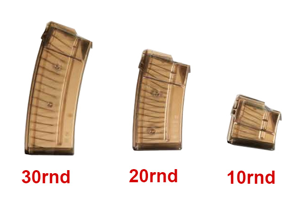

Magazines - for the FAMAE 540 and 543 are interchangeable with the Sig/SAN 550. They come in 5, 20, and 30rnd bodies (pinned to 5rnds in accordance with Canadian law). Manufactured by Sig/SAN in Switzerland, and by Dominion Defence.

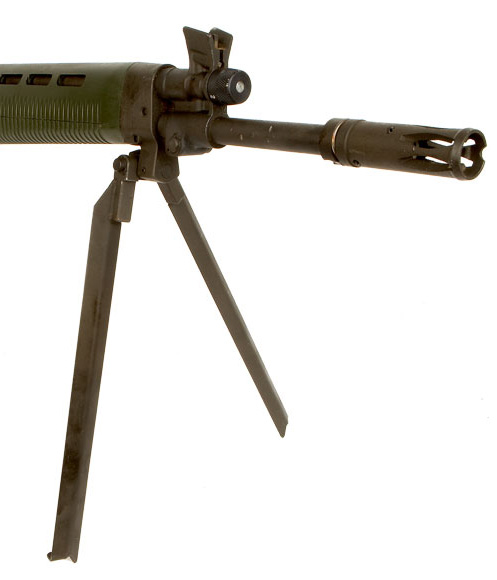

Bipods - are also available. They attach to the bottom lug on the handguard cap and fold underneath the handguard.

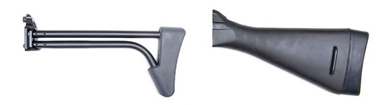

Side folding stocks - are available and are easily replaced by removing the buttstock screw from the fixed stock and replacing the fixed stock with the folding stock assembly, then re-installing the buttstock screw.

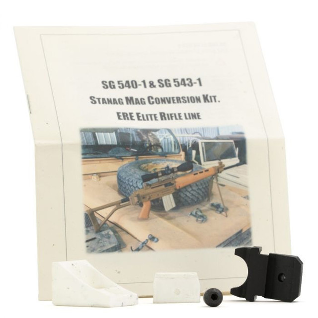

Aftermarket magazine conversion block - for the 540/543 allows for the use of most STANAG magazines.
Aftermarket side-folding stock block - allows for the use of AR15 stocks on the 540/543. GS Designs also has an ACR stock block adapter.

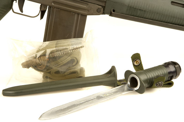

Bayonet - attaches to the flash hider.

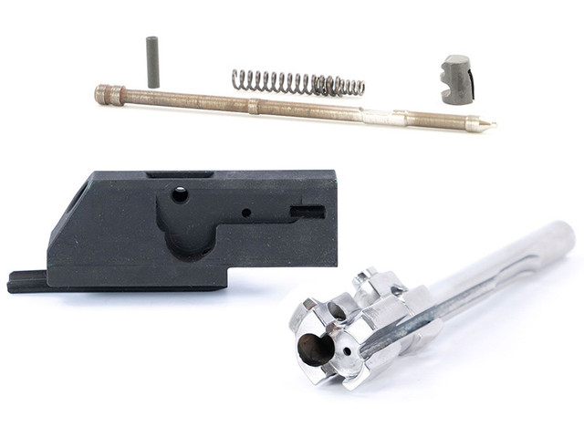

Stripping for Maintenance
1. Make sure the rifle is unloaded and remove the magazine
2. Remove rear pivot pin
3. Push down on the lever on the bolt carrier, and remove the charging handle
4. Withdraw the bolt carrier and bolt. Rotate the bolt counter-clockwise and remove it from the carrier.
5. Remove Front pivot pin
6. Remove handguards by pushing the lower handguard to the rear, detaching it from the upper handguard.
7. With a screwdriver, rotate the bolt on the gasblock so that the “arrow” points towards the muzzle. Then slide the gasblock forward and rotate it 180 degrees.
8. Remove the gas piston and return spring.
9. Remove the gas tube.

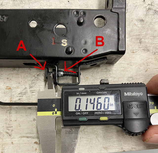

Adjusting the trigger
Using a 6mm and 4mm wrench, turn either the trigger pad (A) or the nut (B) clockwise to shorten the trigger pull distance, or turn counter-clockwise to lengthen the trigger pull distance. Displayed is what is assumed to be the “factory” setting.
