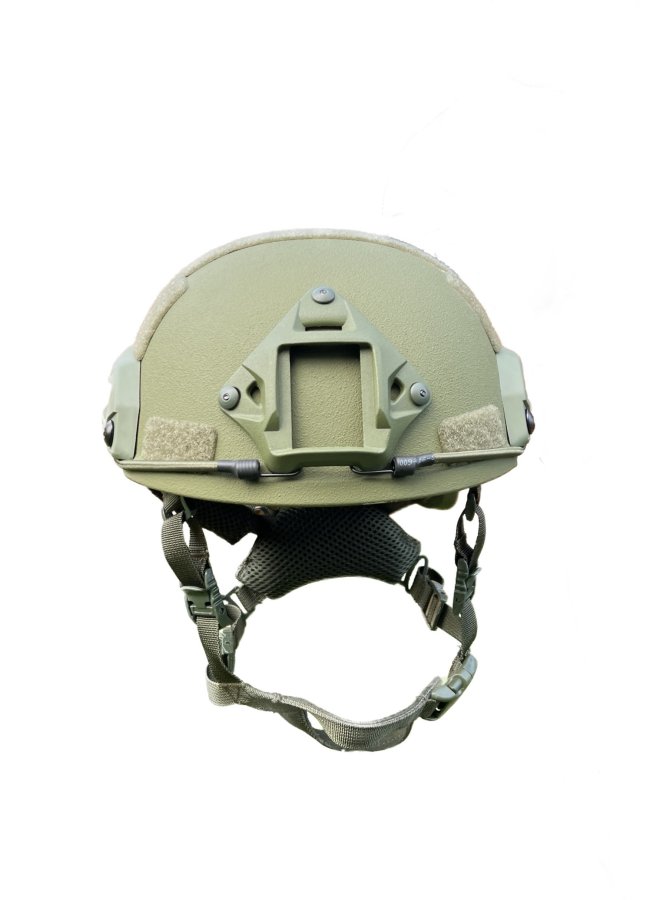

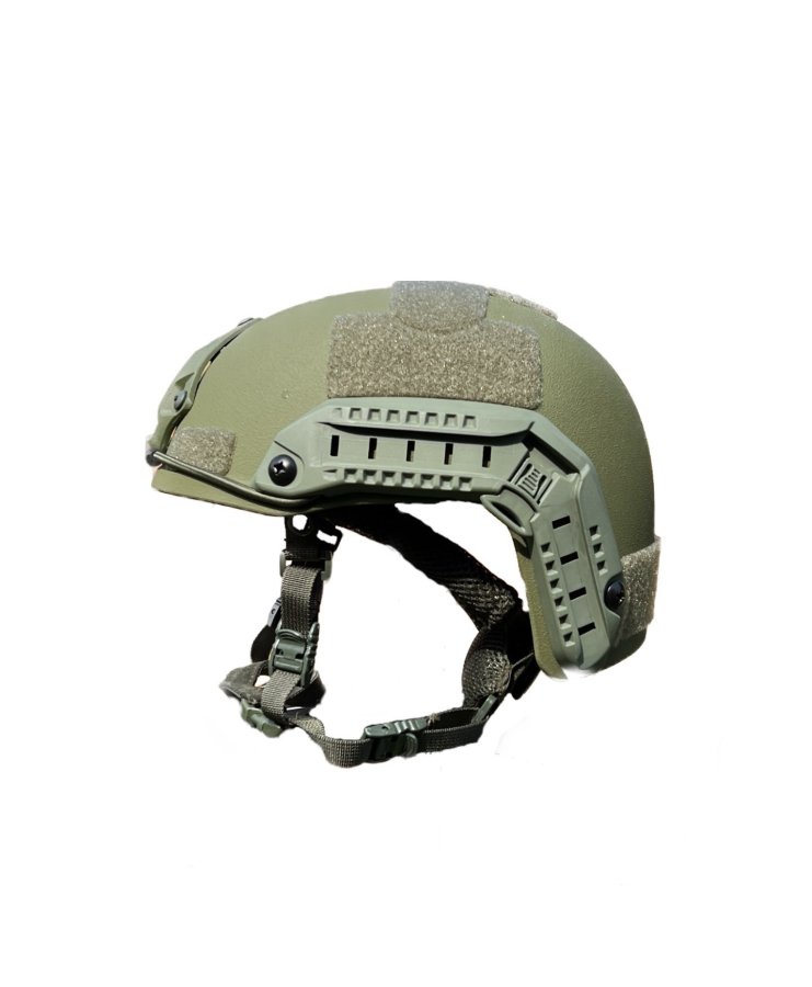

Kevlar FAST Helmet High Cut $595 (Click Here)
Designed and manufactured prioritizing the safety and protection of our users, made from KEVLAR and not substituted with any other material, resulting in the highest performance in BFD(Back Form Deformation): .45ACP 230gr. FMJ at 935fps highest BFD<11.5mm

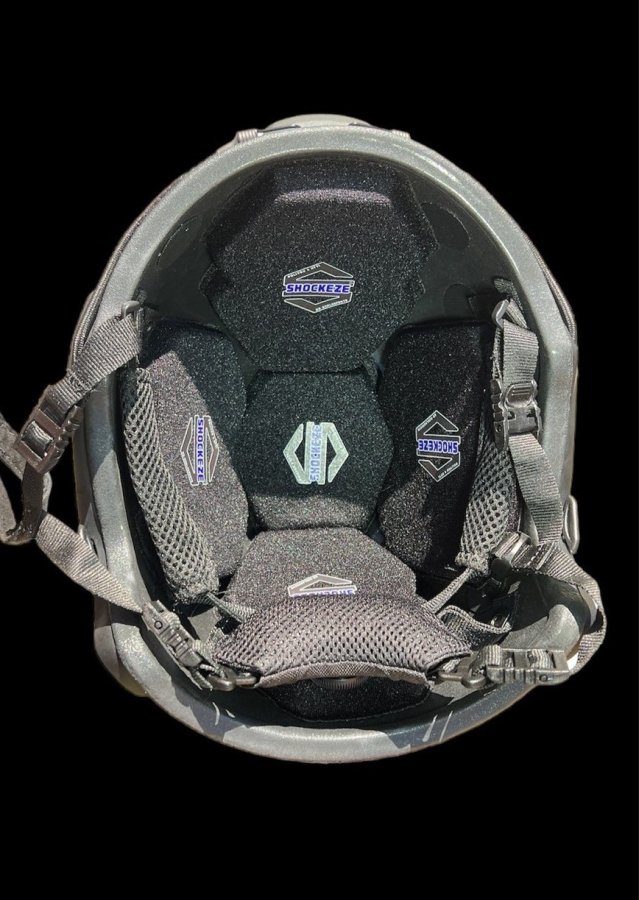

Includes adjustable set of our SHOCKEZE Trauma pads. This material has a recovery rate of over 98% after long-term compression and is capable of absorbing thermal energy up to 50 degrees Celsius without causing irreversible deformation, it can also be washed and air dried for repeated use.
Ranger Green
4 separate sizes and has Size Adjuster for proper fit
Wilcox mount and ARC side rails
To ensure full product history and traceability, unique serial numbers are laser-engraved on the inside of the helmets, this allows us the to know the the day, time, operator, and sourced material of your equipment.
Small: Head circumference 53cm to 55cm Weight: 1.475 kg
Medium: Head circumference 55cm-57cm Weight: 1.52 kg
Large: Head circumference 57cm-59cm Weight: 1.585kg
X-Large: Head circumference 59cm-61 Weight: 1.61 kg
Tested at NTS Chesapeake to meet 0101.06 NIJ Standard (Level IIIA) and record BFD
Colour- Green
5 Year Warranty

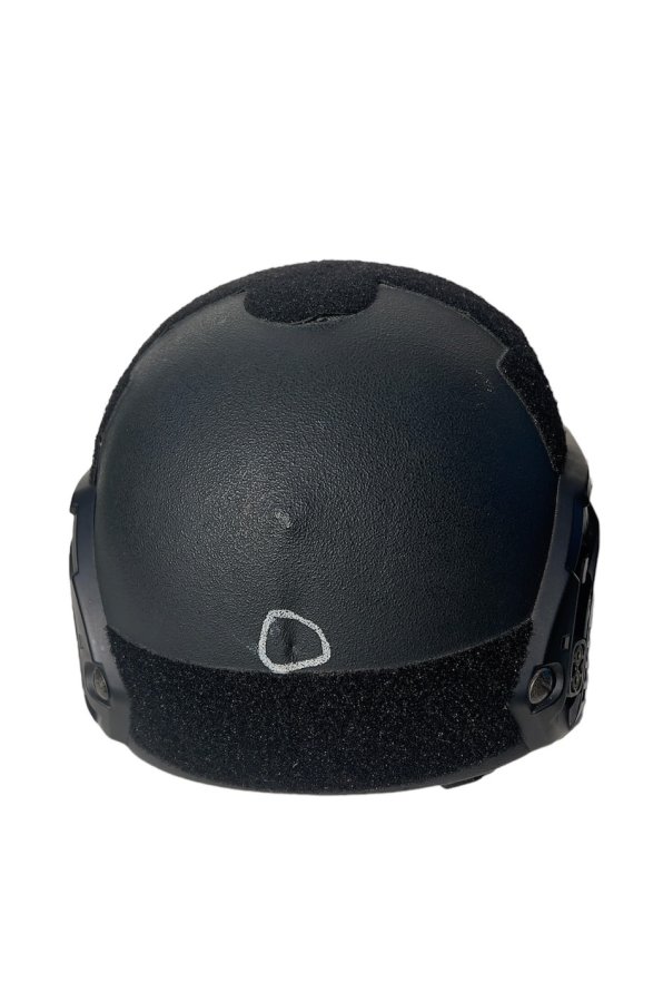

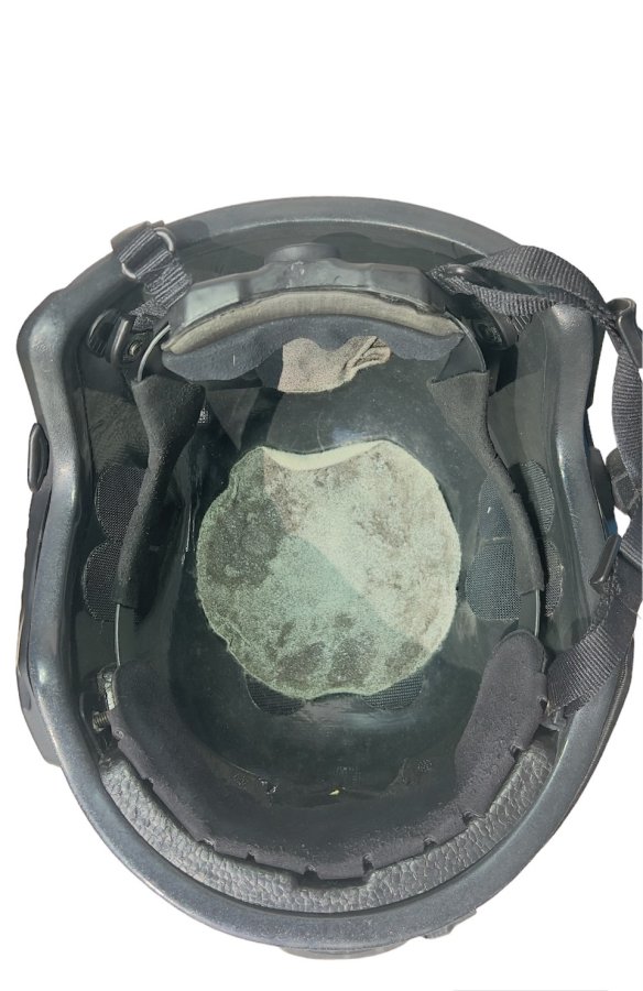

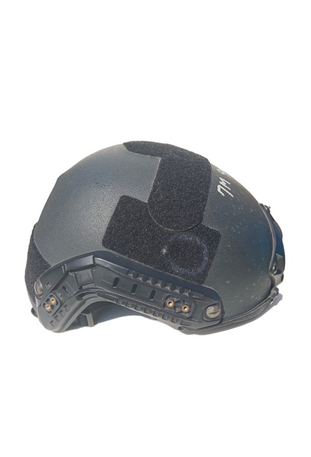

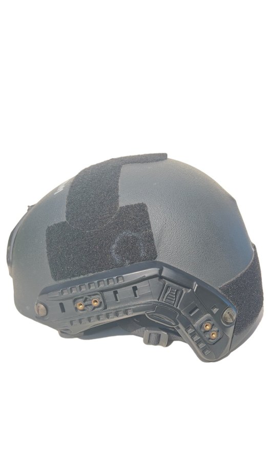

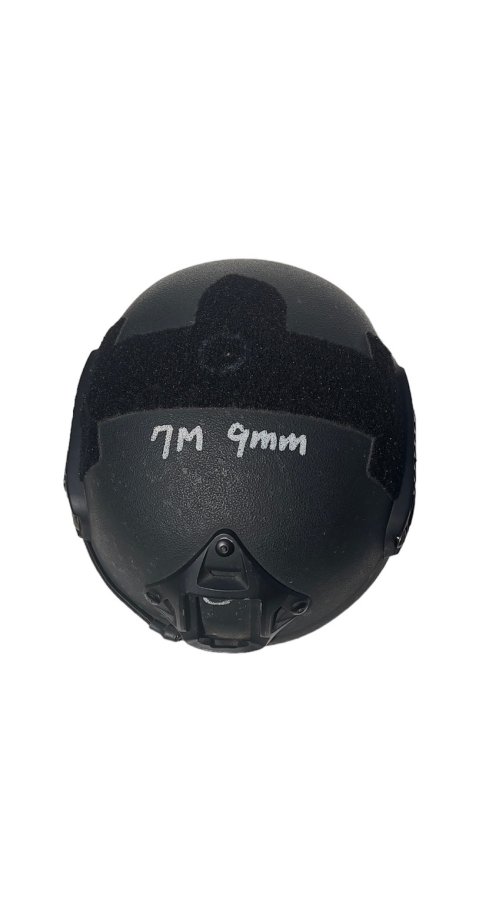

There was plans to do some fun destructive testing on the helmets this summer, but we were a bit busy and behind on things, so hopefully we can get that done in the near future. Here are some pictures of the results of returned helmets from testing.
5 Shots of 9mm 124g FMJ
Front
Side
Side
Top
Inner side with all liner and pads removed to better see BFD
