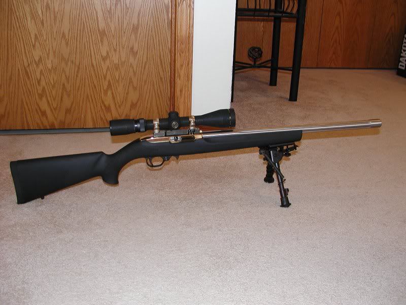

Heres a piccy :D
what i did
Asside from all the VQ internals I added a set of kwik sight receiver mounted
see through mounts and updated those poor sights to a set of willams fire sights. Mind you if this is done the largest scope i could use was a 32mm.
