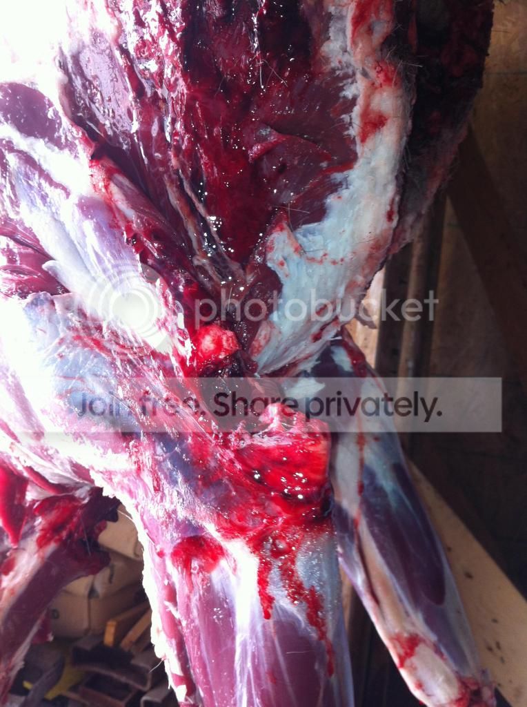

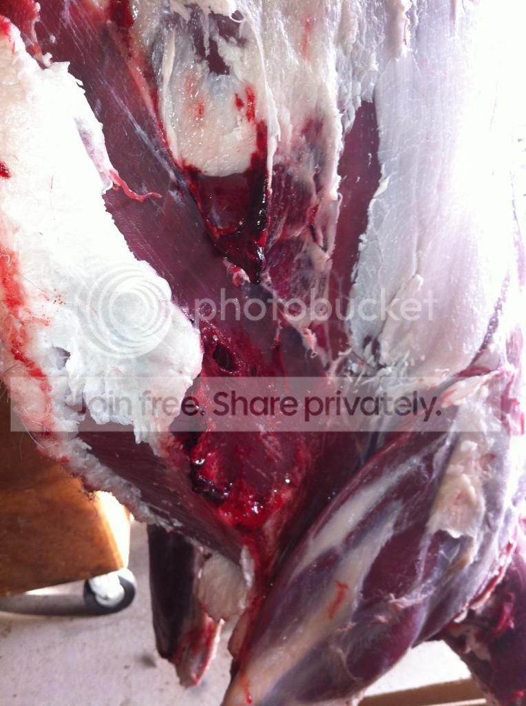

Why not a Winchester 223 rem 55gr Pointed soft point? Worked for me.
Broadside shot through the heart, out the other side and the joint of the leg.
Heart:
Entry:
Exit:
