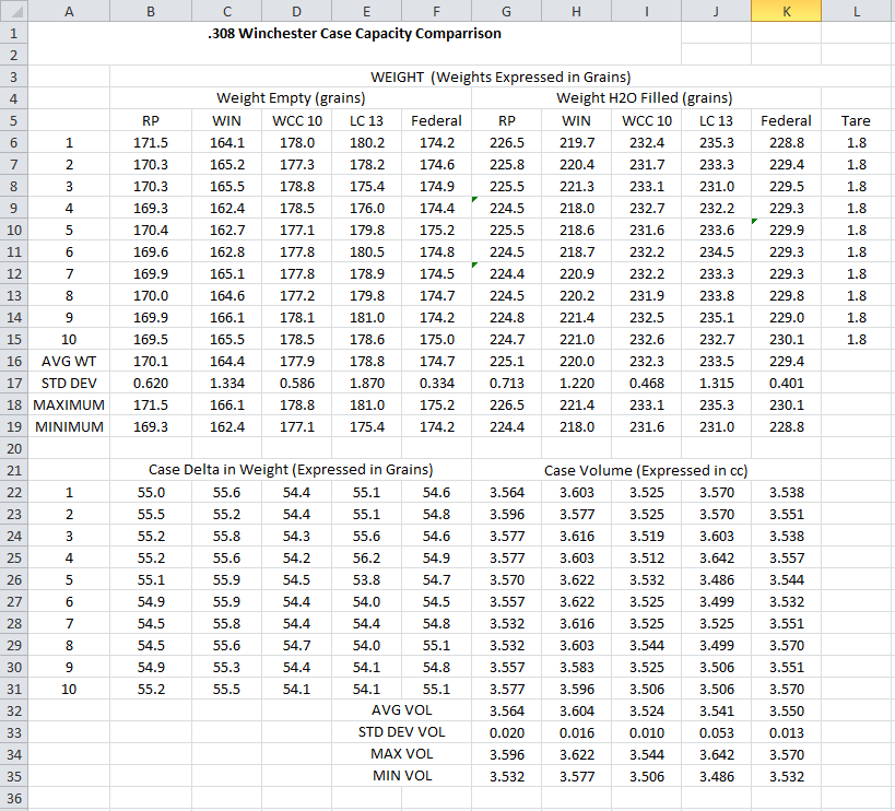

The cases are not the same, the Lake City cases with the NATO cross are made to U.S. Military standards. The Federal cases are made at Lake City when the military contracts for NATO ammunition have been filled, meaning the down time between making NATO 7.62 ammunition. In the chart below you can see the case weights and case volume are not the same even though they are made on the same equipment. The military cases are made of a harder brass and the flash hole web is thicker.
https://thefiringline.com/forums/showpost.php?p=6577732&postcount=13
It looks like the comparison in the link was using commercial federal 308. The Fc 19 is not commercial but rather 7.62 mil spec ammunition with crimped primers. I've never seen commercial brass with date stamp.

This seems to be a more plausible - overrun being sold off. The difference in the brass weight compared with LC is minimal (I have compared commercial FC to LC and saw 5 to 7gn difference).
I'll keep the case for plinking and do my own measurements when it is time to reload this brass. Hopefully I will get a similar reload count as with LC.
