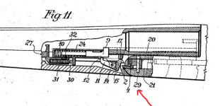

Working on the troubleshooting of FEG and can't figure out how to remove cocking rods. Any advice would be appreciated.
Boxlock (I was able to remove almost everything)
No bottom plate to remove:
Top view.
Front view. Cocking rods I can't figure how to remove.
Rear view and cocking rods. From this side I can push them to the front like half an inch or so, I feel there's spring that returns them back. So I can't push them all the way out from this side and can't push them out from the front. And I don't see anything that holds them inside. No retention pin or anything. I tried to push forward, grab the end that sticks out and rotate it - it rotates a tiny bit and stops. I'm lacking experience with shotguns to figure this out, so I'm asking for help.
