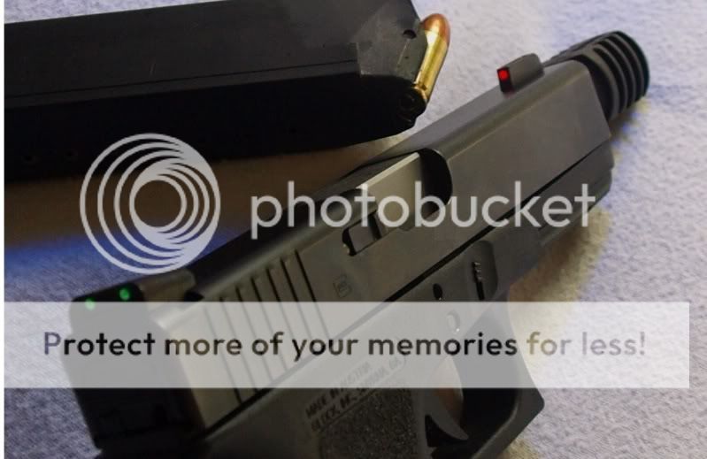

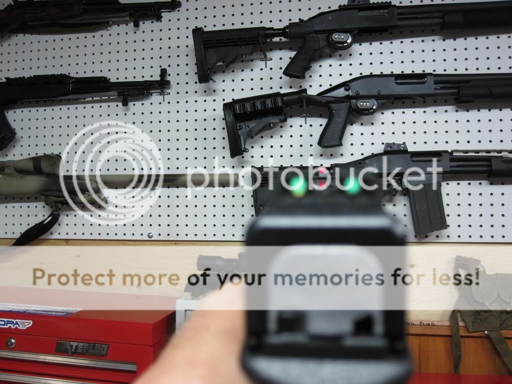

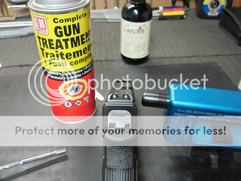

When I took the Black Badge course the instructor was an IPSC grand master and he used the red front, green rear fiber sights. He was the fastest shooter I have ever seen in person. I recently put them on my G34. Target acquisition is amazing. Love them!
I agree, those fiber sights are pretty impressive ... personally I would like to try the flat black rear sights (no fiber) with a fiber front sight, might give it a very distinctive feel...
