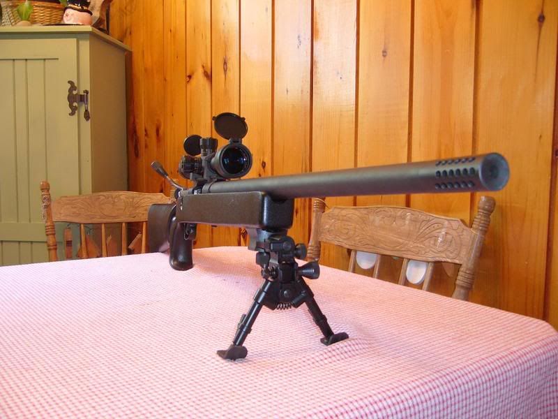

November 2006 I sent out my camo painted FN Mauser 98 to get some work done to it. I just today I received it back to me and man does it look nice.
FN Mauser 98
Dura Coated
24" Harts SS( .1260" at the action, .960" at the muzzle)
VIAS Brake
Custom Bolt Handle
Single Shot Follower
Bedded and Free Floated
Near Mfg 20 MOA Base and IOR Rings topped off with a Bushnell 3200 10X40.
Timiney Trigger

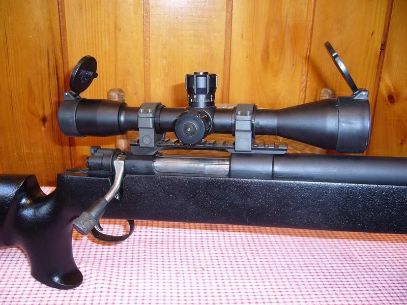

5-7" Versa Pod.

Range Report.....
Shoots close to a ragged hole at 50m but its 18-24" high, I think due to the 20MOA base I cannot bring the scope ( Bushnell 3200 ) down any lower. So I need to mount my Luepy or a Non MOA base.
I found this with my Parker Hale 1200V that has the near rail with a Zeiss Conquest 6.5-20..
I simply went out and bought a Nightforce so I can get to zero.. It is out now @ Alberta Tactical Rifles getting a new bolt handle and 8-40 screws installed for the rail.
