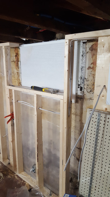

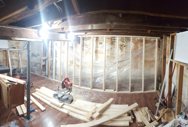

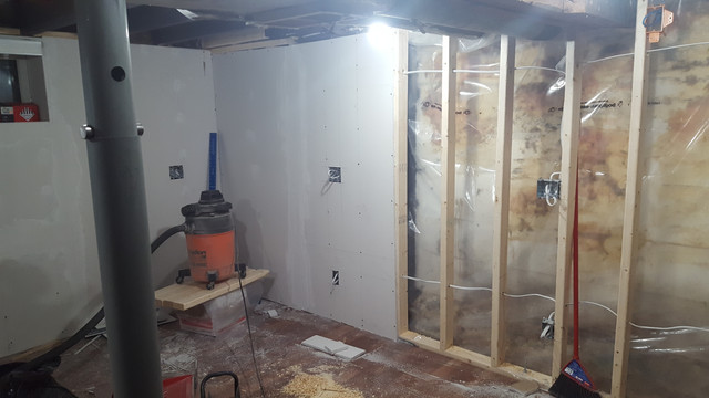

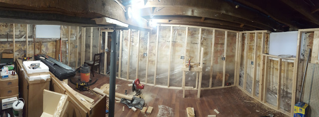

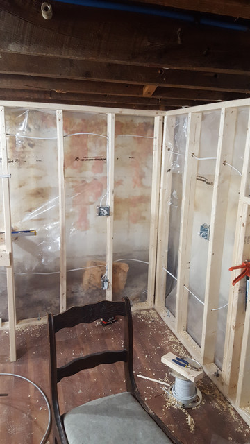

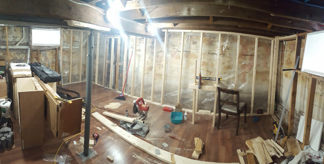

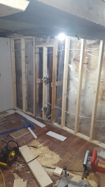

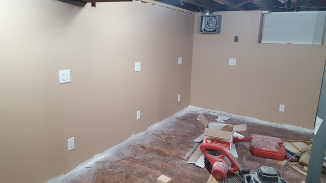

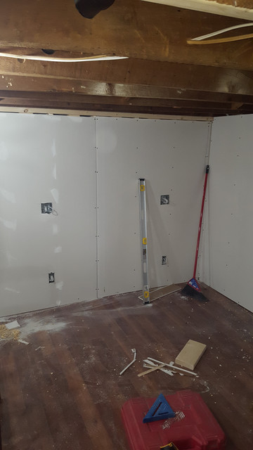

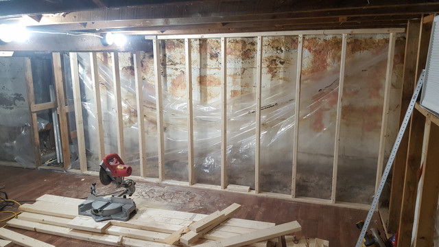

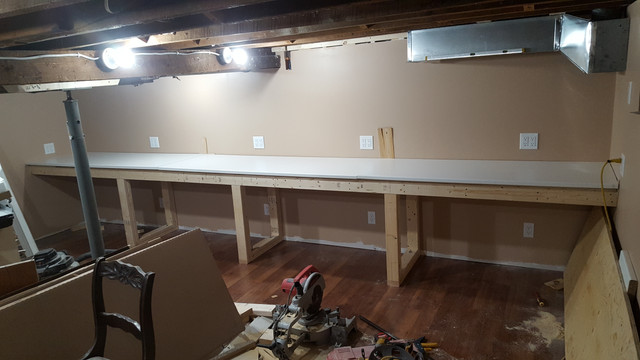

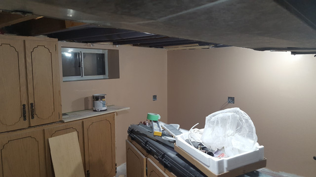

I bought my first house back in May and after alot of repairs (1930's house, idiot people attempted reno's) I have finally started building my reloading/gun/work room in the basement. The basement is boarder line tall enough (6 foot tall in most places) so i couldn't put in a ceiling. I tore down the existing wall and wood panelling to discovery several issues (Mice, bad plumbing and electrical) that have since been fixed. I didn't insulate the new wall because mice will likely get back in (until i can properly seal the house up) but i did put in vapour barrier.

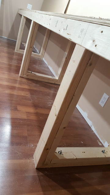

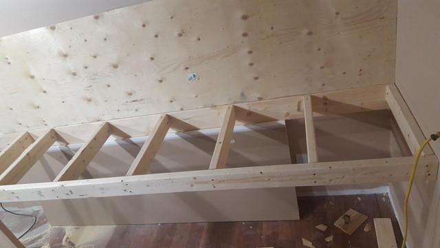

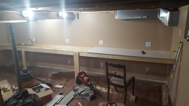

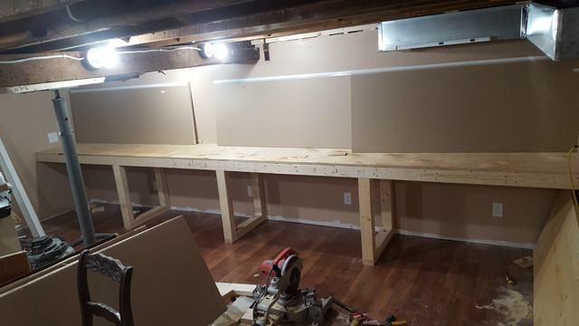

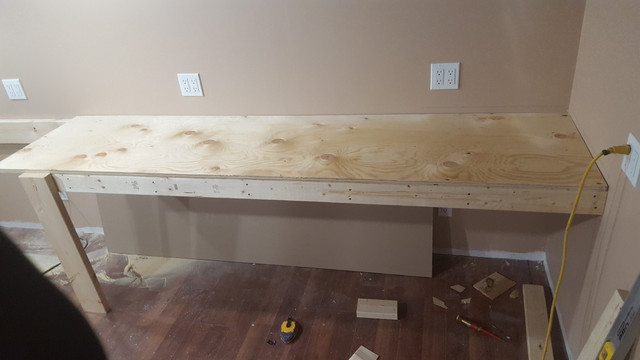

I put a 2x6 along the wall screwed into the studs and built the rest with 2x4's. The top of the bench is a single layer of 3/4" plywood with ikea 1 1/8" thick counter top screwed and glued to the plywood. The 3 support legs are 2x4's glued and screwed together with two 3/8" lags into the foundation. Not as over built as I originally planned but plenty strong enough for my purposes. Ammo, component and tool storage is to the left with more to come later on. The left side of the bench will be all my presses, the middle i plan to wall mount a monitor for reloading info/entertainment and on the right side will be my casting / powder coating station.

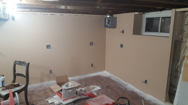

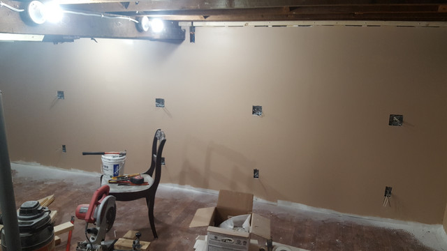

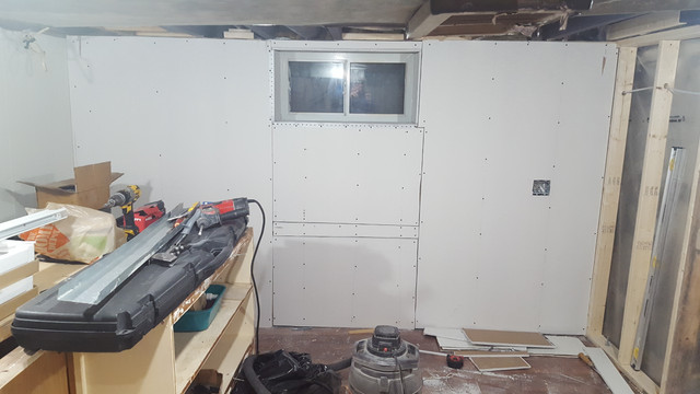

I was able to get a 240 cfm exhaust fan for free from work for the casting section. I attached a 8x8" duct to the fan and plan to have two or three 4" round flexible ducts coming off it to go to the various spots that need exhausting. I will be putting in a filter rack in the main duct then a pre filter for the powder coating station. I wanted a lot of plugs so i didn't have to put in power bars so 18 outlets went in but of course after i boarded, mudded and painted i then thought about putting air lines and central vacuum piping for the bench but it's not the end of the world.
Anyhow enough rambling, here is the progress so far.
