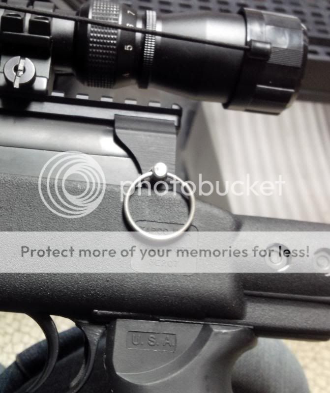

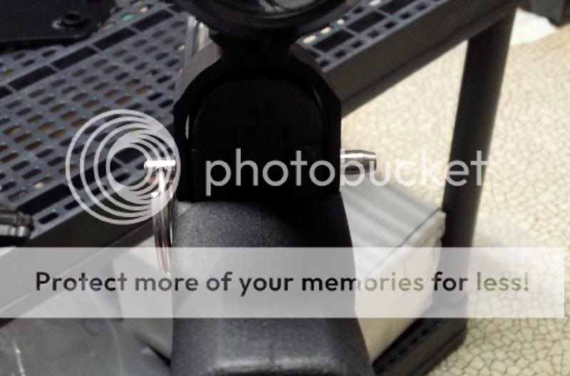

This little 6mm bolt to lock the rail in place on my SKS was just horrible on my quick rail. The Allen keys that came with it just stripped, the Allen head on both sides was stripped after 1 use. So I looked up some quick pins from one of the industrial suppliers we use at my work and picked up a couple of these pins. Couldn't be happier now!

I figured the bolt was needed to hold a zero on a scope?
Does anything hold that pin in, or is it just friction?
The pin is the exact same Ø as the bolt, and it has a spring loaded detent ball to keep it from coming out on its own, but mine is a snug fit which will make sure it never comes out, and probably keeps the zero on the rail.
