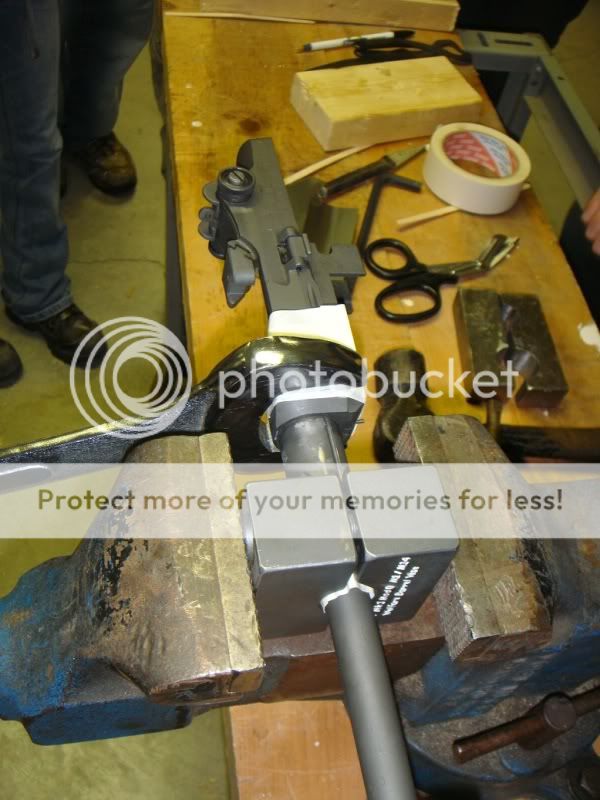

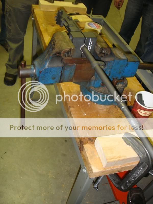

Welcome to the club....they are a nice rifle......If your front sight is leaning to the right it and you are going to use iron sights ..the barrel needs indexing (tightened onto the receiver a bit) If you plan on putting a scope on it dont worry about it... good news is it is easy to do ,,,,bad news you need a special block to clamp barrel into the vice .
I just did mine at one of Hungrys m-14 clinics....
First we removed flash eliminator and entire gas system then clamped barrel and receiver in a vise using special barrel clamp
this is a pic of how the wrench is used to tighten the receiver onto the barrel ....hopefully you can attend one of Hungrys clinics if not a gunsmith locally may be the best idea
