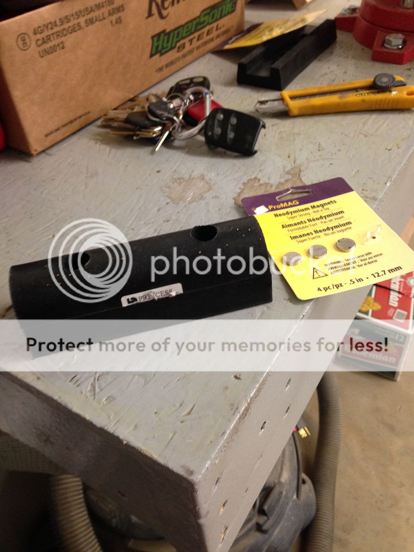

Was in the holiest of hardware (PrincessAuto) looking for one particular item then dawned on me to browse and see if they had anything I could use to make these jaws.

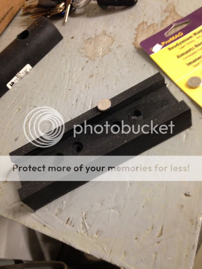

Through the trailer section I went and found these bumpers for boats.
A Ukrainian eye measurement and off to the table saw and into the press to drill some 1/2" holes to counter sink the magnets.

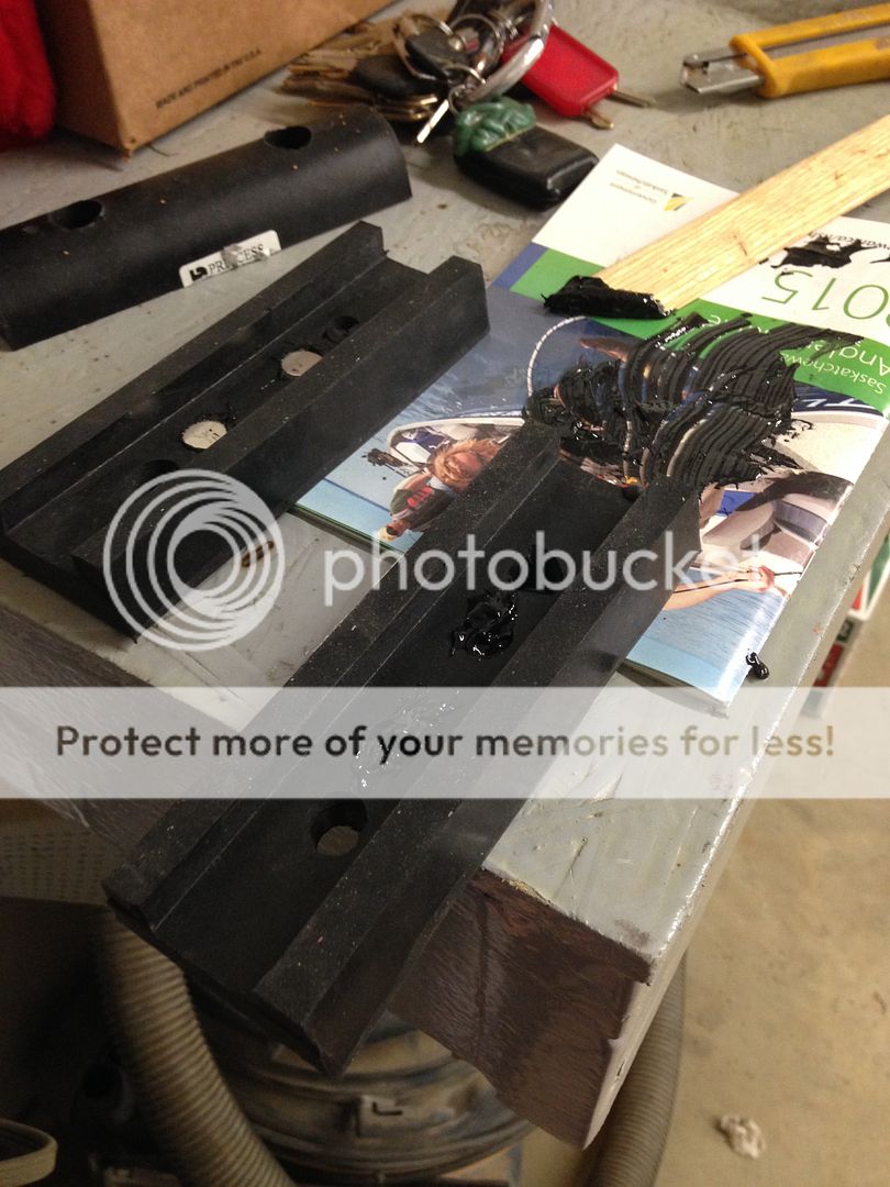

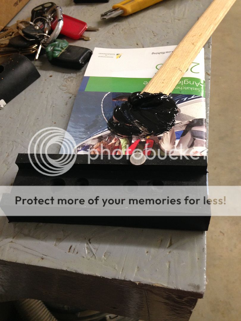

Mix some Proform epoxy.

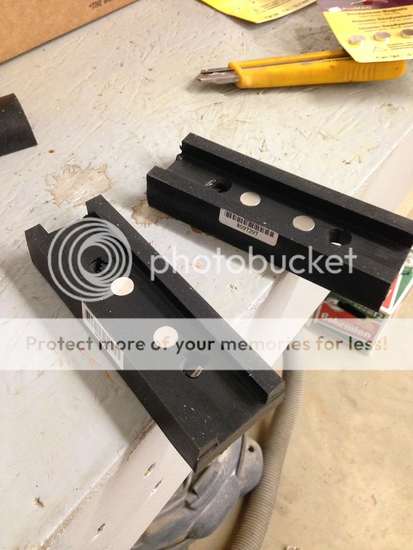

Fill holes and set in magnets.Careful, they pulled themselves together full of black sticky goo nice. ;) pull then apart and fiddled them back in.
Clean up extra epoxy with thinner.

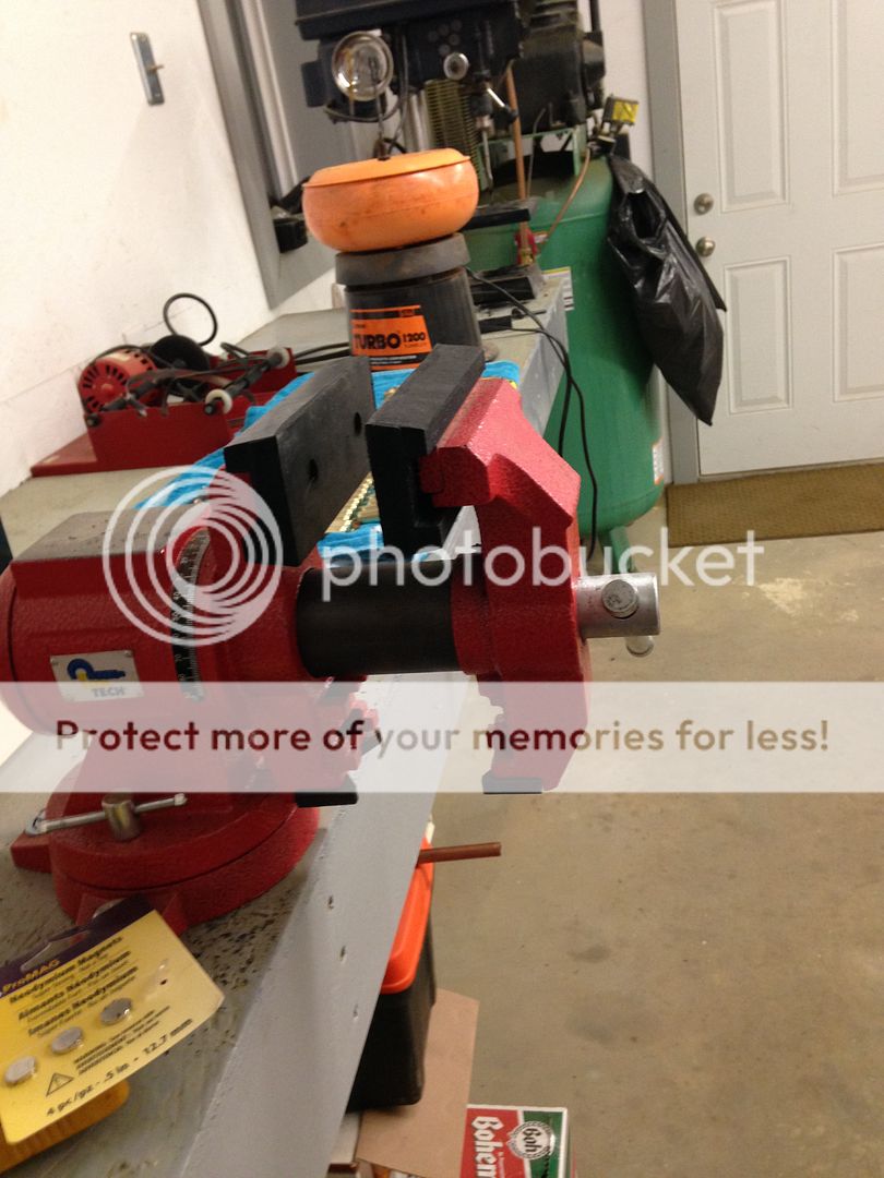

Their new home when needed.
$20.00 investment.
Wicked home project. I have some delrin that I made to cover mine, but just had elastics to hold them in place. The magnets are just what I needed (there are a bunch around here somewhere). I see you enjoy the "good stuff" as well. I have a couple dozen Boh on the shelf in my pantry; always a must on the return trip into SK.
If you want to increase the grip, rubber supply houses have a heavy rubber foam, grips like crazy. Just glue a 1" thick pad to each side your in business. Great idea using the bumpers.
