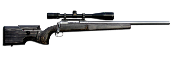

I cannot remember who finished my stock and I hope this gentleman steps forward he if reads this. He is a Canadian painter/stock finisher and he did an excellent job of finishing my A5L Laminate stock. The price was very reasonable and the turn around very quick.
I wanted a clear coat matte finish and the stock turned out great. I can take some pictures if you want?
