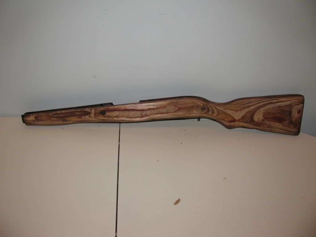

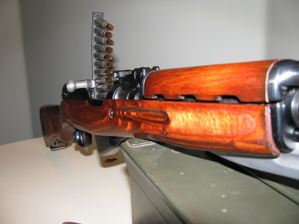

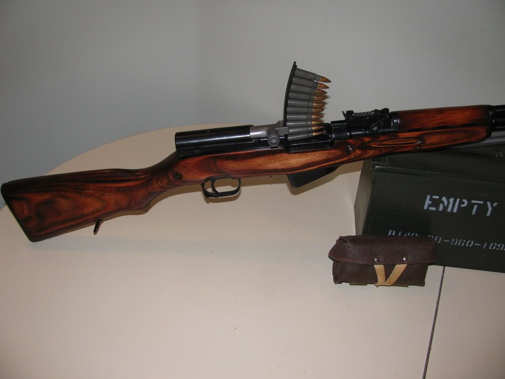

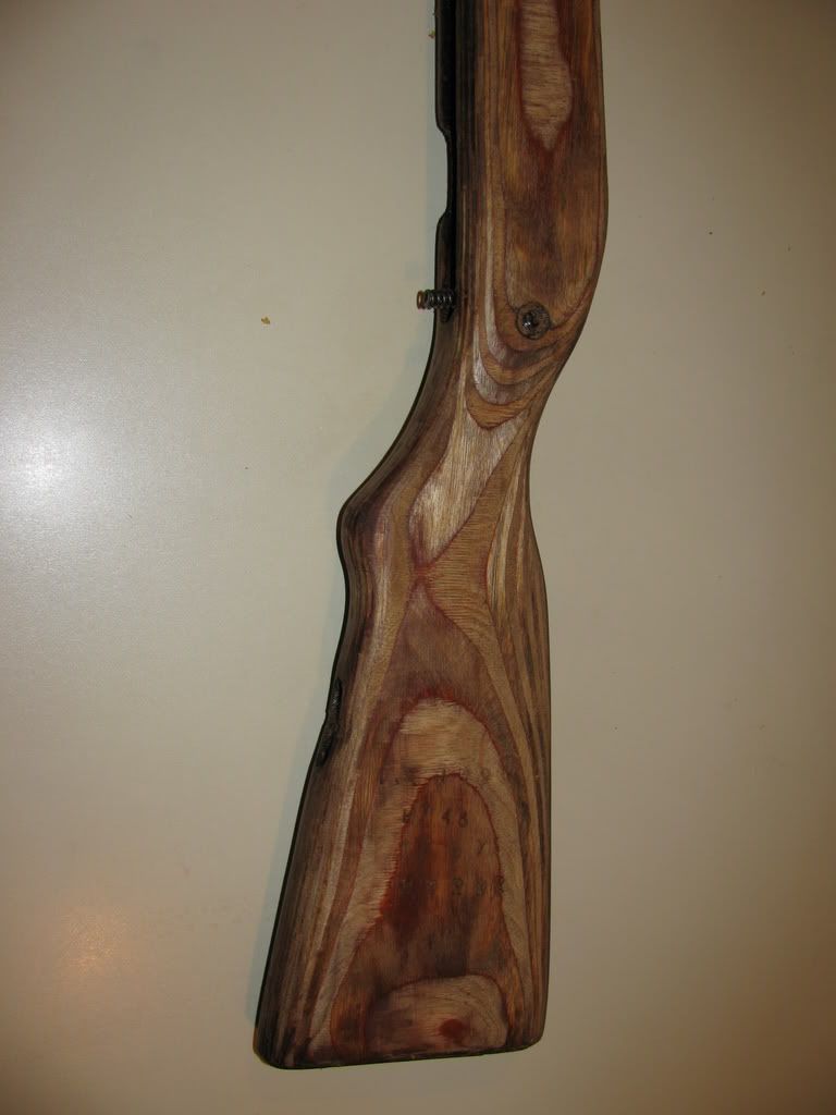

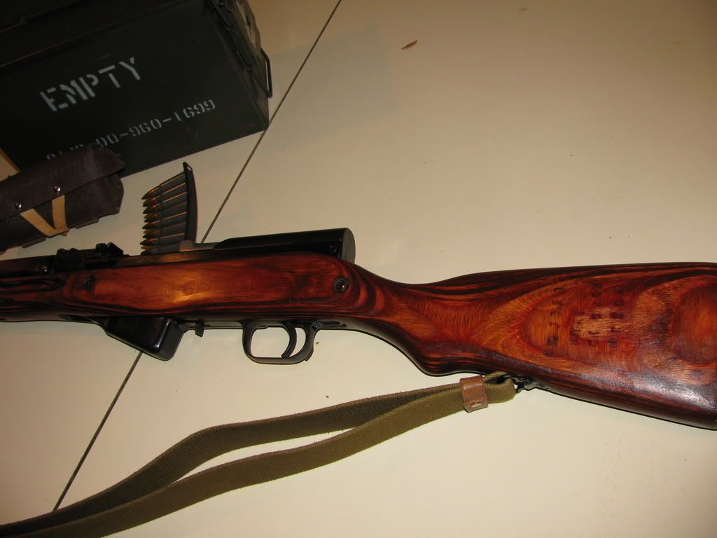

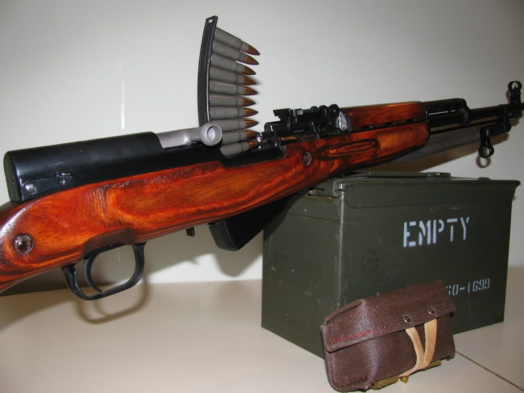

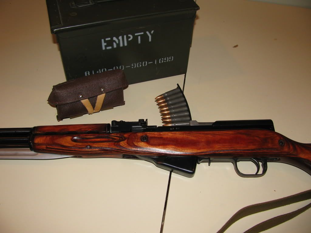

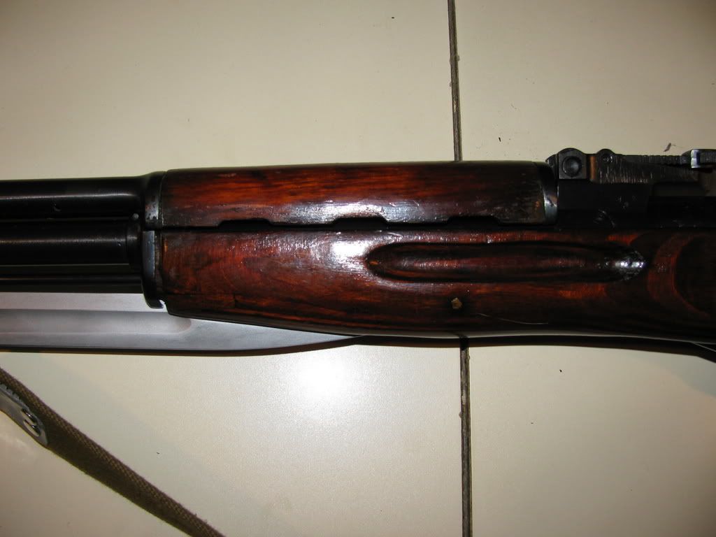

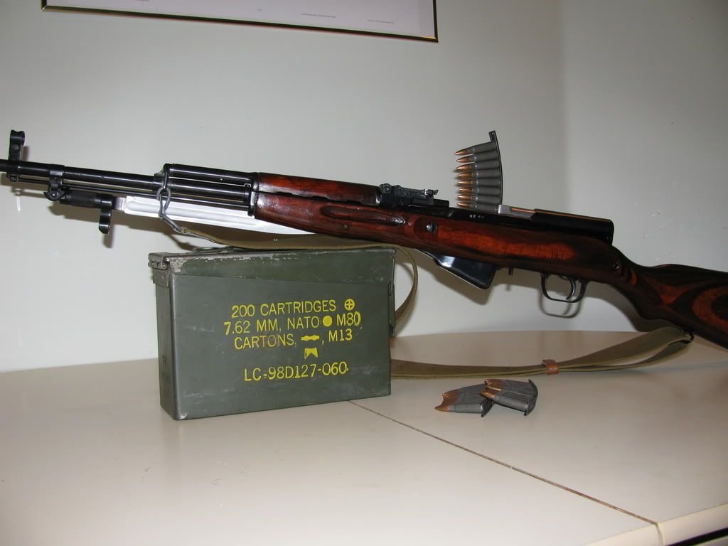

Hey guys I started work on refinishing my Russian sks stock about 3 weeks ago and its done and the rifles back together. I got some pics of what the gun looked like befor and after for you to see. I used a nice red stain on the stock then a product called liquid plastic that is made to protect wood and give it a nice shine. I think it looks way beter then it use to.
These two pics are befor I started removing the finish off the stock
These are taken after using furnisher striper to get the old finish off the stock. But befor I sanded the stock down.
These Pics are of the finished stock all back together.
I dont know ,I think you need to do a few more to perfect your proccess.Ill send mine,just to help you out,LOL Good work looks nice.Dave

Heres what I did to the stock if any of you guys want to know. I striped the stock with furnisher striper and a paint scraper took little over an hour and a half. Then sanded the stock with 60 grit all the way till 320 grit. After that I got some stain I used minwax (Sedona red) put two coats of that on and let it dry for around 3 days. Got that stain at home depot if your looking for it. After drying I used a product called (liquid plastic) its pretty well just a clear urethane for finishing wood. Put two coats of that on , sanding in between with 00 steelwool. After drying I put on some bees wax for a little beter shine
