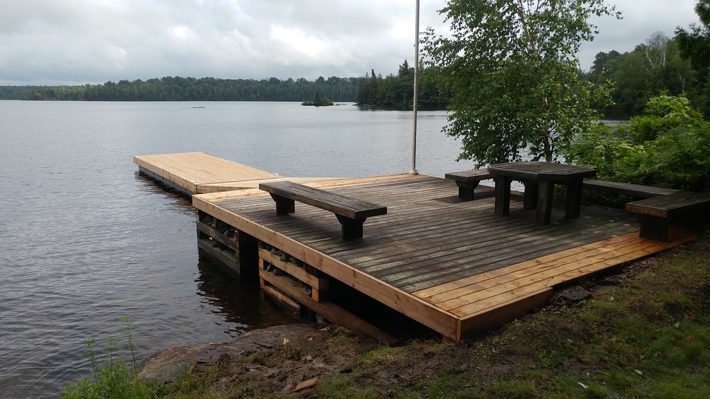

We bought this place just before Christmas last year and after the snow and ice melted off we discovered the dock had some serious ice damage. So this year the major project has been replacing most of the dock and repairing whatever could be salvaged.
Essentially the only things that were saved was a portion of the decking from the shoreline deck area and some of the old crib timbers. We removed the two existing support cribs and replaced them with four new larger cribs and filled with 5 tons of rock each (20 tons of rock total). Additionally we connected all the cribs so they act as one unit and anchored them to the bedrock using red-head rock anchors. Fairly certain this should hold up for a good number of years as the old system lasted 17 years according to my nearest neighbour. The deck is 16x16 and the dock itself is 24 feet by 8 feet on floating PE pontoons. It is connected to the shore deck by a hinged floating (PE pontoons) 8 foot wide by 12 foot long ramp. The end of the dock is about 44 feet from shore in about 6 feet of water. Floating sections are anchored to 4 x 350 lb concrete anchors.
About 3/4s of the way out looking back at shore:
From the view above I own 1000 feet of shore to the right and 2200 feet to left. Property size is 117 acres and backs onto 10,000+ acres of crown on 2 sides.
View of the dock from shore:
