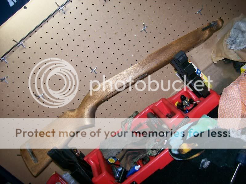

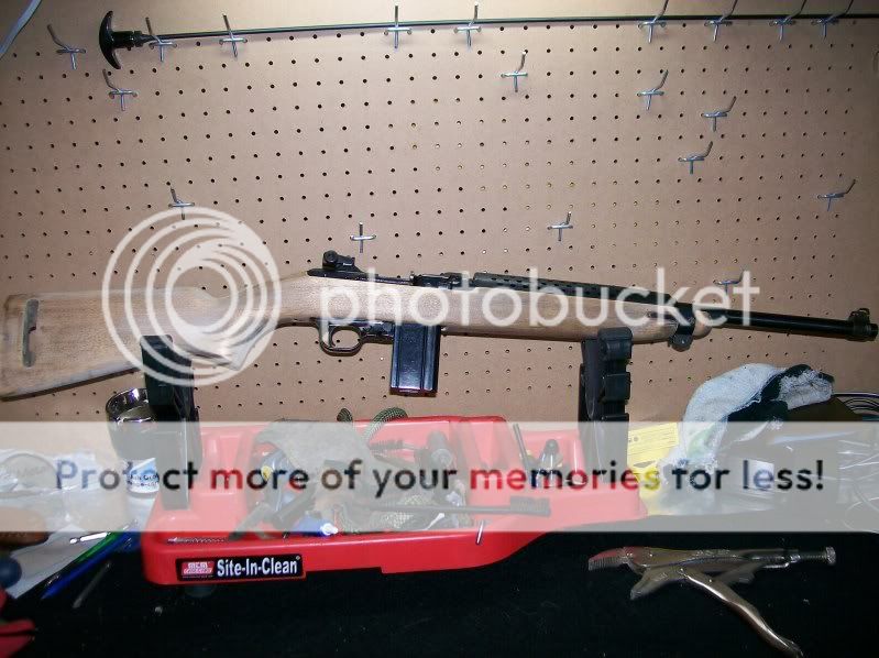

I just got an M1 carbine from a fellow nutter , an el boggo universal with a deep varnish finish on it , with a few scratches , so decided to clean old finish off it and it came clean nicely with paint stripper . and a wipe down with alcahol.
its still a bit darker in the piccy because i just wiped it with the alcahol its actually really white
anyway what should i finish the wood with ? linseed, wax,
i dont want to varnish it again , so advise please from guys who re finished stocks would be awesome

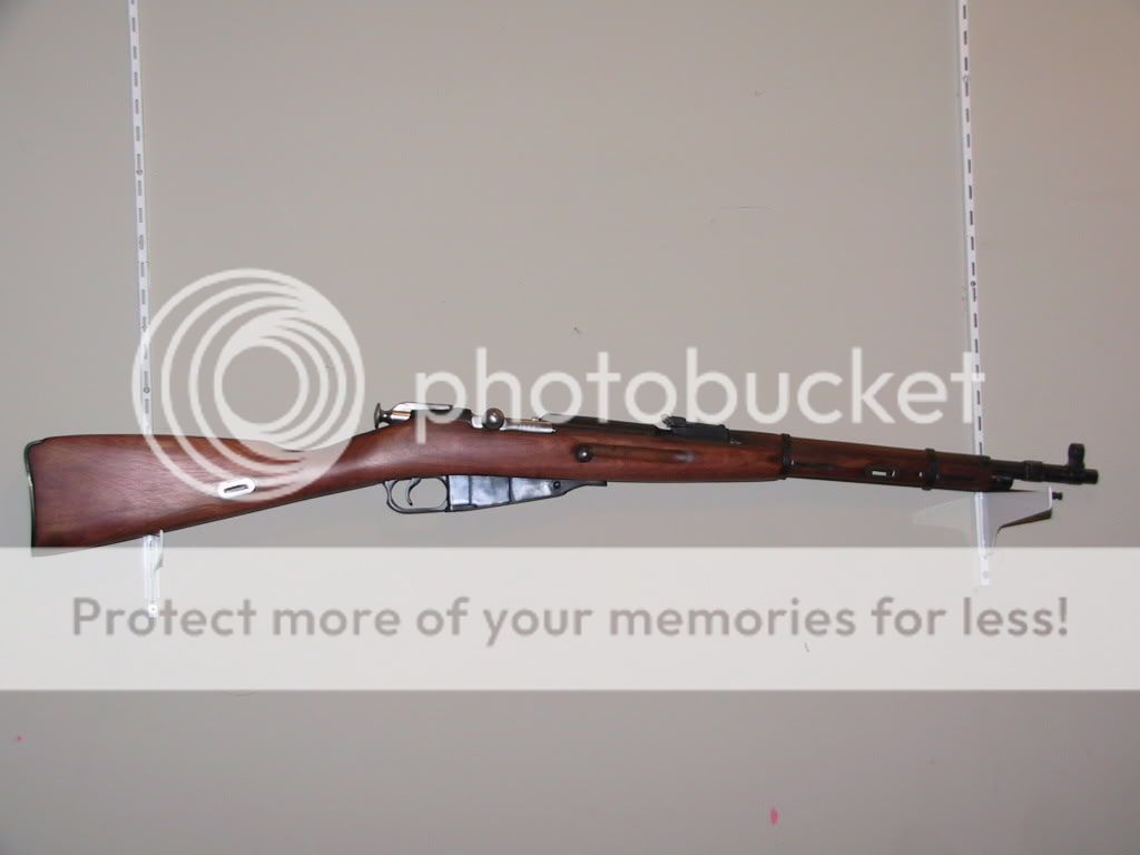

Heres an example of tung oil. M44 with 6 or 8 coats(can't remember) of tung over a cabernet stain I did for a friend.The bayo was cut off by a previous owner.

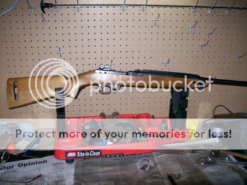

well i stripped the ol girl with paint stripper , it came off real good .as it had a real dark varnish on it and scratched .
and i gave it a light rubbing with really fine wire wool.
then diluted tung oil a few coats . then a few coats of undiluted tong oil
i didnt stain first as i thought the wood looked nice , and it will apparently darken with age . any way im pleased with the end result .
