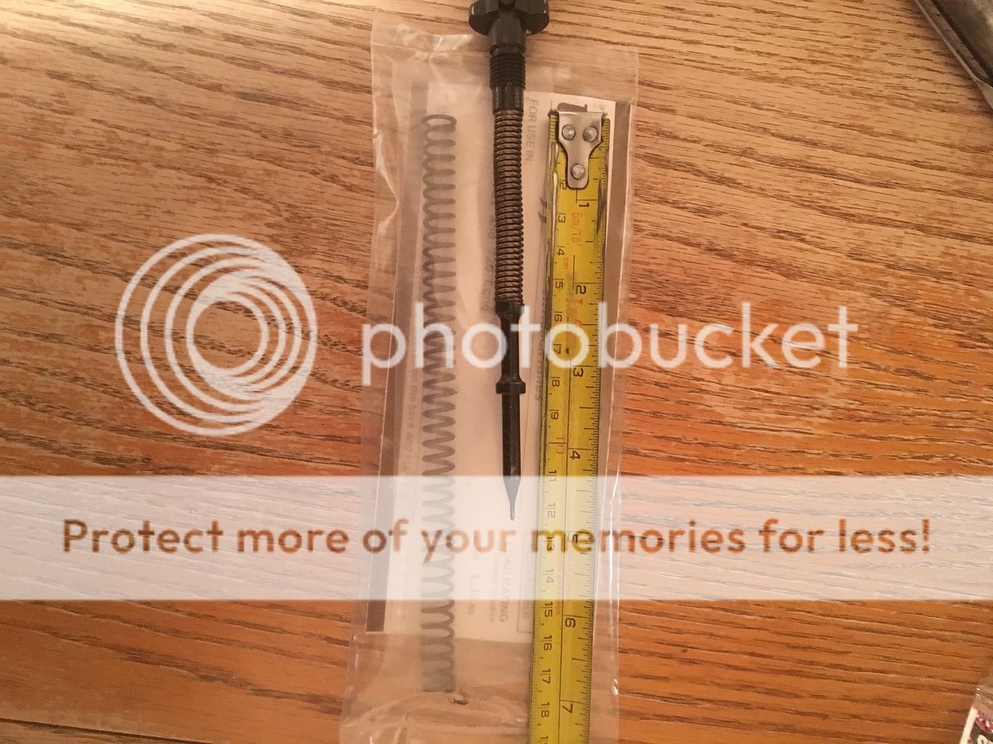

I don't worry about springs being in tension in storage. They are under a lot of tension whether its left cocked or not. Take a typical bolt action for instance. A uninstalled spring is about a foot long and installed its about 3". Another 1/4" isnt going to make a bit of difference. The big factor in spring wear is flex cycles. Worst comes to worst, springs are cheap.

That's because they aren't measurements; just numbers to make a point. Here is a picture to make the same point, namely that the installed length is already so much shorter than the uncompressed length that cocked or un-cocked isn't going to make any difference. Do you disagree with that?

I've never left my guns in a cocked position for storage. Just fussy that way. Ye wouldn't leave a hammer gun cocked in the safe would ye? The shorter compression length on most bolt guns ain't too big a worry, but ye still have extra stored energy in that spring that can cause the spring to take a set over time which can slow the lock time a bit. Not a big deal fer hunters, but a big deal to match shooters.
