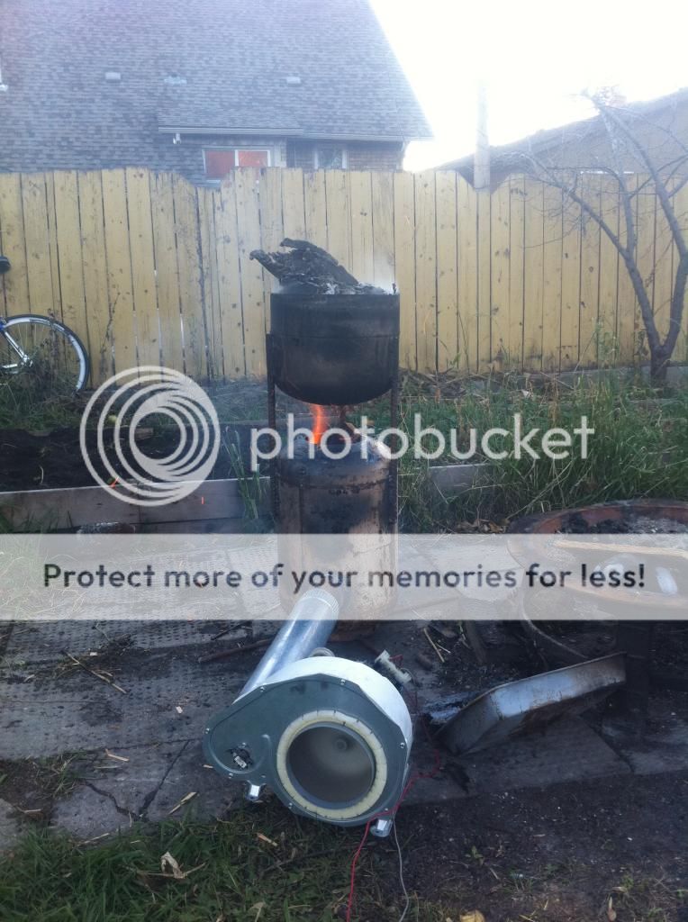

Finally got around to building a big melter for scrap lead. 4 pounds at a time on a 1000 watt hotplate was starting to get on my nerves. Runs on scrap would from 2x4s or pallets from work because I'm too cheap to run a turkey burner on propane. :p First melt today was about 120 pounds of pure lead and from start up to completed melt took 20 minutes. Next step is rigging up a valve and a spout for bottom pouring. This thing sure does go through alot of wood in a hurry though.
Initial start up.

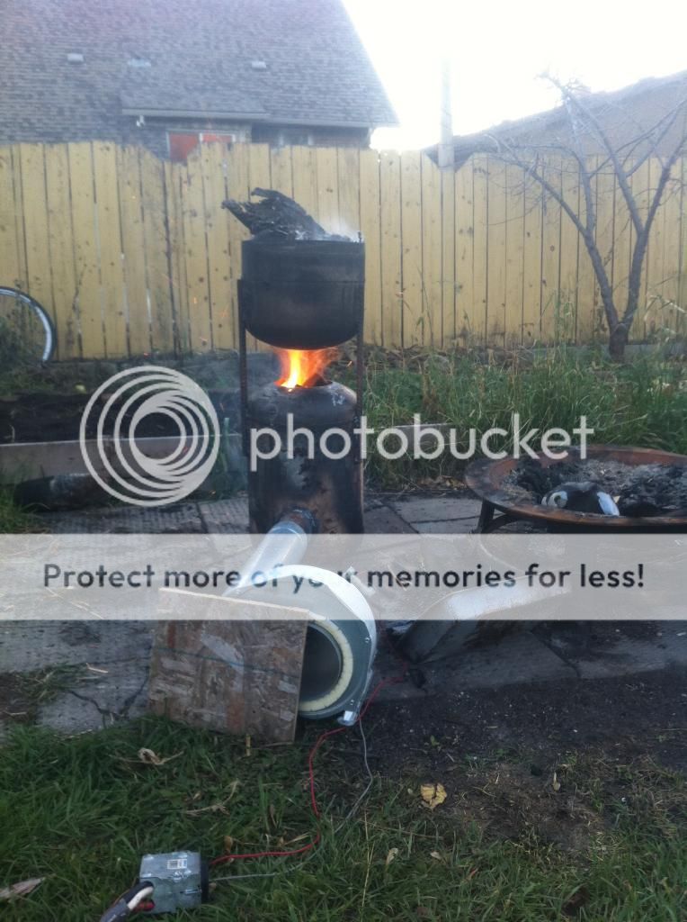

Getting all the wood burning.

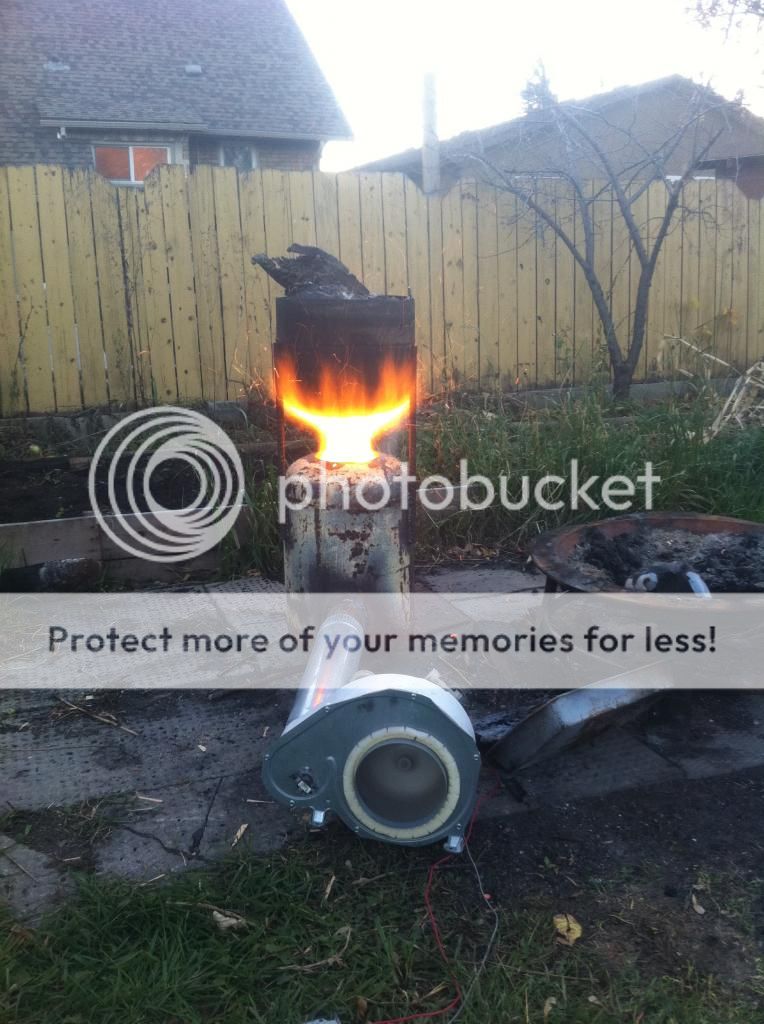

Full power! Ain't nobody got time for waiting!
Yeah, 30 pounder on bottom, 20 pounder on top. Blower is salvaged from an old dryer someone threw away. Not sure what the lead originally was, the guy I got it off of said it was melted out of something. I didn't get any details. Compared to my range scrap ingots, these are dead soft.
