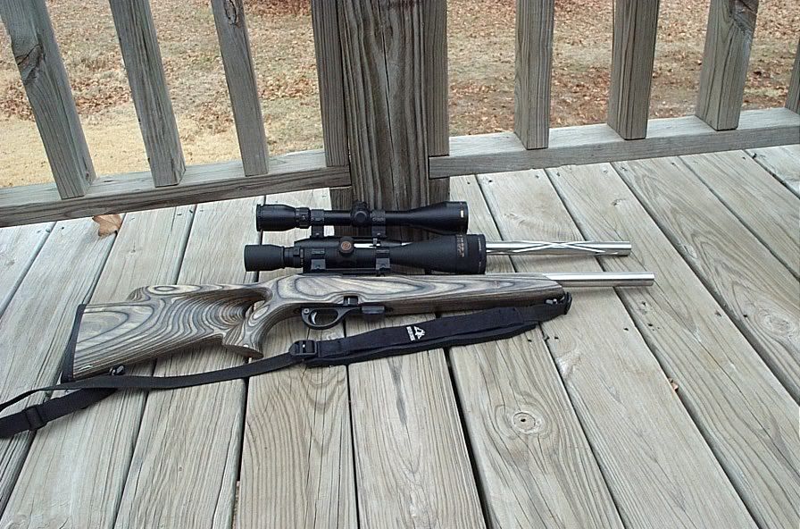

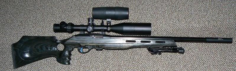

I'm swimming against the flow I know, But don't discount the 597... it can be had for cheap and there is some aftermarket for it...
Not my pics here, borrowed from RFC...
