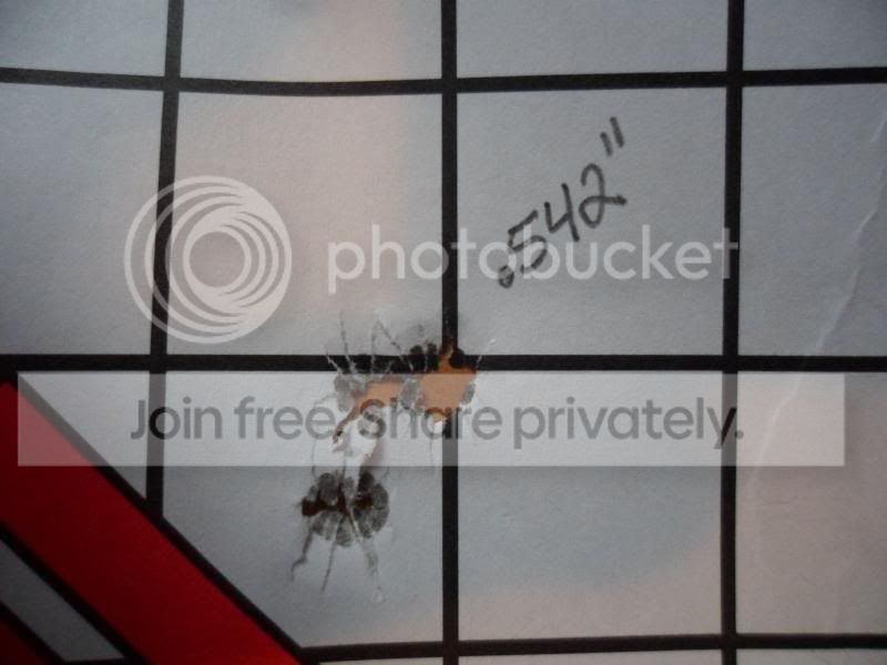

Like the title says. I jumped into the reloading world.
got out today and let some rounds fly.
not too sure how to analyze the data. so if you want to chime in please do.
first loads were:
30-06 Hornady case
H4350
CCI 250
165g AccuBond
I loaded from 52g-55g in 1grain increments 3-shots each
Here is my best group at 52g. odd thing is all other groups were 2-2.5". shot at 100yrds

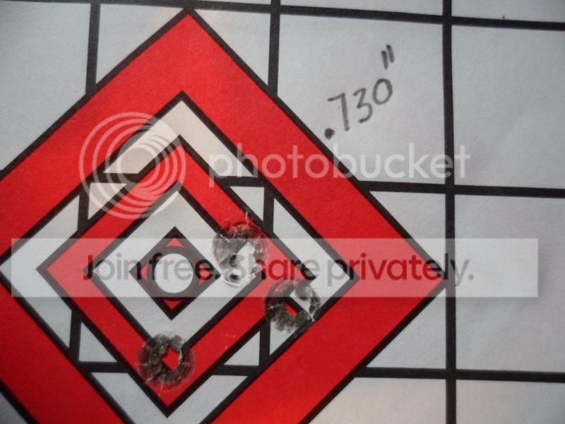

second set was
30-06 Hornady case
H4350
CCI 250
190g Berger VLD Hunting
same loads as above. and the same thing best group at 52g and the rest around 2-2.5"
so what dose it all mean.
the AccuBonds are wicked in the accuracy department.

52gr of 4350 will be mighty slow. I would bump up a lot. Most of the best results for 165gr are 56.5-59gr of h4350. Im shooting 57gr at 2830fps from a 22" barrel. Hodgdon data says start at 53gr and max is 59gr for 165's and h4350. Accuracy is good but you steel need some speed to go with it.
that's what I was thinking. so you think I should go progressively higher.
I would yes. I would go until I see pressure and then work with the most accurate load
To give some perspective I started at 55.5gr of h4350 and 165gr hornady set's. Velocity was 2686 fps. Groups were right around .5" though. Went all the way up to 59 and was seeing pressure signs. Groups at 57gr for me are still in the .5-.75" range. Depending on the gun and load not every powder charge will shoot tight. It will open up and then close again.
When load testing a 30-06, using a 1 grain increment might be a bit too big of a jump. I've used .5 grain increments when doing the initial tests, then narrowed it down .2 grains at a time.
