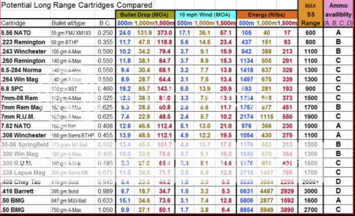

Hey everyone so I'm relatively new to larger caliber firearms and I'm looking for a long range deer rifle with the ability to shoot targets at long range (800 minimum). I basically want a rifle that I can take hunting this fall as I've never gone, but I also want it to shoot well out at longer ranges. Basically my question is what caliber and rifle will allow me to do this? I've been looking into the 7mm Rem Mag and 7mm RUM and am pretty set on one of those and I was wondering if someone could tell me the pros and cons of those. What are some pros and cons of some similar cartridges? I've been leaning towards the 7mm Rem Mag as it seems very versatile. I don't really have a budget, I know getting out to long ranges gets expensive, I'd rather spend more money on something that works well and will continue working for a long time.
I do plan on starting to handload for this rifle. I currently know very little about that subject as well but hey thats part of the reason I'm on this forum.
Basically I'm looking for a versatile long range cartridge that will not only get out to minimum 800 yds, but also kill at that range. And a rifle that I can take hunting and wont be afraid of getting bumped but still can hold up at the range. If someone could give me some more info and insight that would be appreciated.
Here is a chart I've been doing some quick comparing on.
Thanks.
I'd start with a 7-08 if you load your own ammo. A .308 if not.
Long barrel life, less recoil, more practice. When you're ready you can step up to a 7mm Rem Mag and handle it well.

It looks like quite a few 7mm-08 fans here. I really wish I could shoot them both and decide which one feels better. Ammo isn't really a huge concern because no one within 45 minutes sells ammo at all. I live 45 mins from saskatoon which obviously has basically any ammo I can think of. And I really want to learn to handload.
Just by these comments, I'm assuming the two 7mm calibers recoil quite a bit more than a 308? Is there any way someone could describe how much more?

Sounds like you've got to get some shooting experience under your belt. The 7-08 will recoil less than the .308. The 7mm mag will have more recoil than the .308, but less than the 300 win mag. I'd have to agree with Hoyt on this one for sure, get some good practice time in with the .308 and see how it handles/shoots at the yardage you want to shoot. For a relatively new shooter, you can read all the ballistic charts you want, but at the end of the day if you can't do it with a .308, you won't be able do it with anything else. Try the .308 out to 800 plus yards, if you can do your part, the rifle will follow; if not consider more reasonable distances for shooting until you get the hang of it. As others have said, don't shoot beyond your capabilities, the game deserves better.
