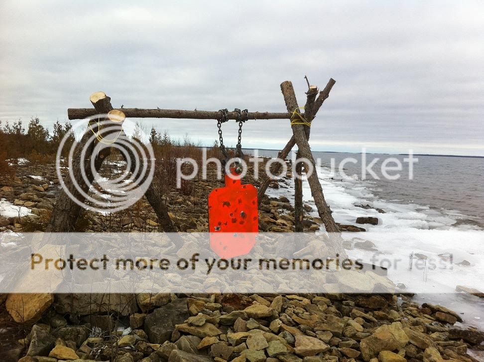

Targets were set up at 800m, 1040m, 1260m & 1605m.

By the time I got to the last 1605m target setup I only had 10 rounds remaining. I was on in 2 shots, 20.5MIL elevation and 5.5MIL of windage (and allot of luck). But as the photo does not lie I only made 4 hits at 1605m.

Great Pics and Awesome shooting. Good on ya for putting the work into getting the targets out there too. It's not like you could just drive up to the target with your truck. Boat yes but rocky shoreline, makeshift stands etc.
