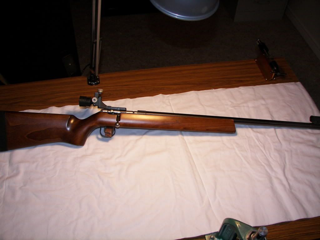

if you are looking for something to target shoot with, shop around and get a used .22 target rifle, they are usually around the $200-250 mark and the difference will be night and day.
excellent sights, better stock, better heavy barrel, better trigger. unless you get the target model savage .22, which is $400, the sights on it will be quite poor and youll probably end up scoping it.
of course if you intend to use this for stalking around and hunting then the target rifle is too big and unwieldy.... but they are great for sniping critters from a fixed position though.
something like:
a .22 bolt action is a great choice for a first gun, itll fire just about any ammo and is very cheap to shoot.
i stole the anschutz .22 image from the EE, its still on sale - perhaps you could get the guy down on price a bit?
