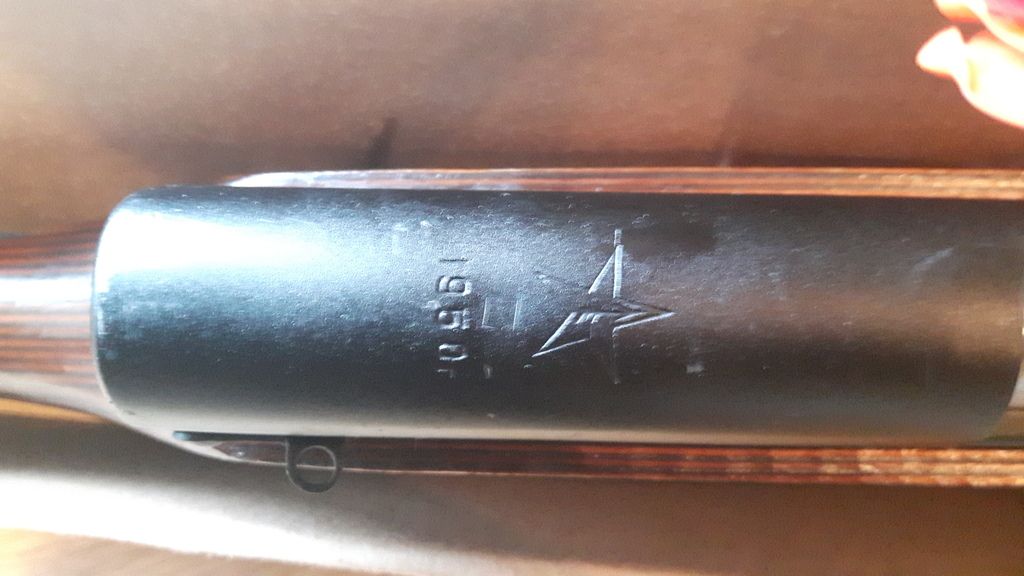

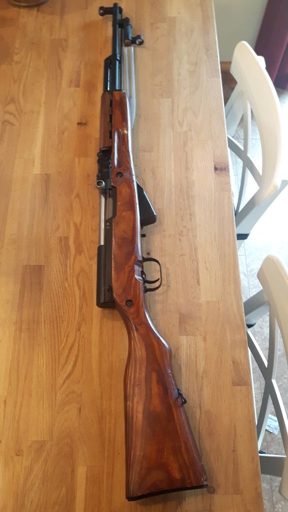

Just got my first sks, a 1950 Tula refurb. Bore looks good though it's not chromed. Stocks beat up here and there but everything is tight. I'm trying to figure out what parts are original? I know the stock is refurb and it's got the refurb mark on the receiver cover. But it's got a spring firing pin and the non chromed bore so I figure those parts are original.

Nice looking sks. The most important thing to look for in them is the crown of the muzzle. How sharp it is and if not rounded or worn. With non chromed barrels it is much easier to damage it during cleaning than chromed barrels that are much harder. Soldiers used steel rod and thus damage can occur. Other than that if crown is good, it is going to be very accurate with majority of ammo on the market right now. Reloads will probably increase accuracy even further.

an interesting thing about sks is the moment you got your first one you'll find yourself wanting another one. They really tend to multiply... welcome to the club! It is good that you've ignored all the sks-hating snobs out there. I am sure you will enjoy it for many years and it will be as good as it is today so you will pass it to your grand children!
The non-chromed bore doesn't like Bubba style rapid fire. If the bore is new or at least fairly fresh, keep your fire rate real slow, at least until it all warms up.
The assembly that makes up the bayonet lug and front sight is a big fat sleeve over the barrel that warms (and expands) way slower than the barrel beneath.
Rapid fire from cold will beat the crap out of that segment, because that "sleeve" isn't letting it expand with the rest of the barrel.
Eventually, that part of the bore nearest the muzzle will be cooked, leaving a burnt out SKS with no accuracy, and maybe even toppling (keyholing) rounds.
