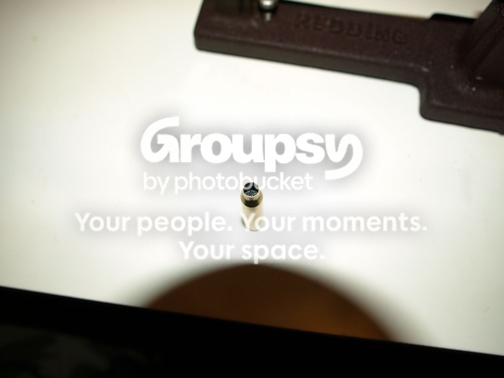

To the OP, you really should look into getting some check weights. Every single time I go out to my reloading bench, I calibrate my scale to zero, then I drop some check weights in the range of the load I'll be using onto the scale. EVERY SINGLE TIME. Accidents happen, but I'd prefer to keep the accidents on the cheap and easy to fix side, rather than the KABOOM side of things.
....But out of curiosity, you said it's range brass. Might it be military brass? They have less capacity in their cases due to the thicker walls. Do you have any reloading manuals to reference?
This isn't correct for 5.56/.223 brass. Any differences are within normal variation between manufacturers.
