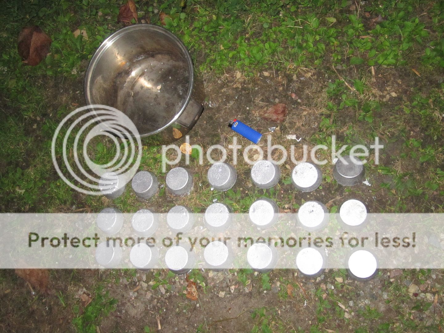

First try at melting wheel weights and some "what not to do" tips.
After that first, failed attempt I've had no issues.

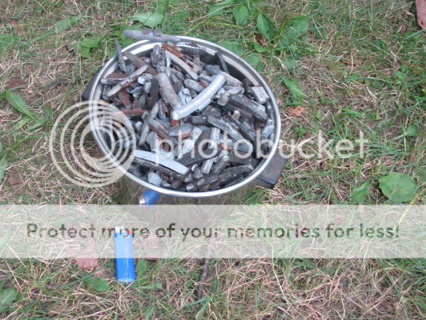

Now have just over 120lbs in muffin-tin ingots, and one more bucket to go. I do sort before melting now, and leave about 1/2" of "known good" remaining in my pot. Once the known good is melted, I continue to add weights. The few zinc that sneak through my sorting obviously float on the surface of the melt. It really is pretty straightforward.
Once I've got some more confidence in my process I'll try purposely adding some zinc for hardness.

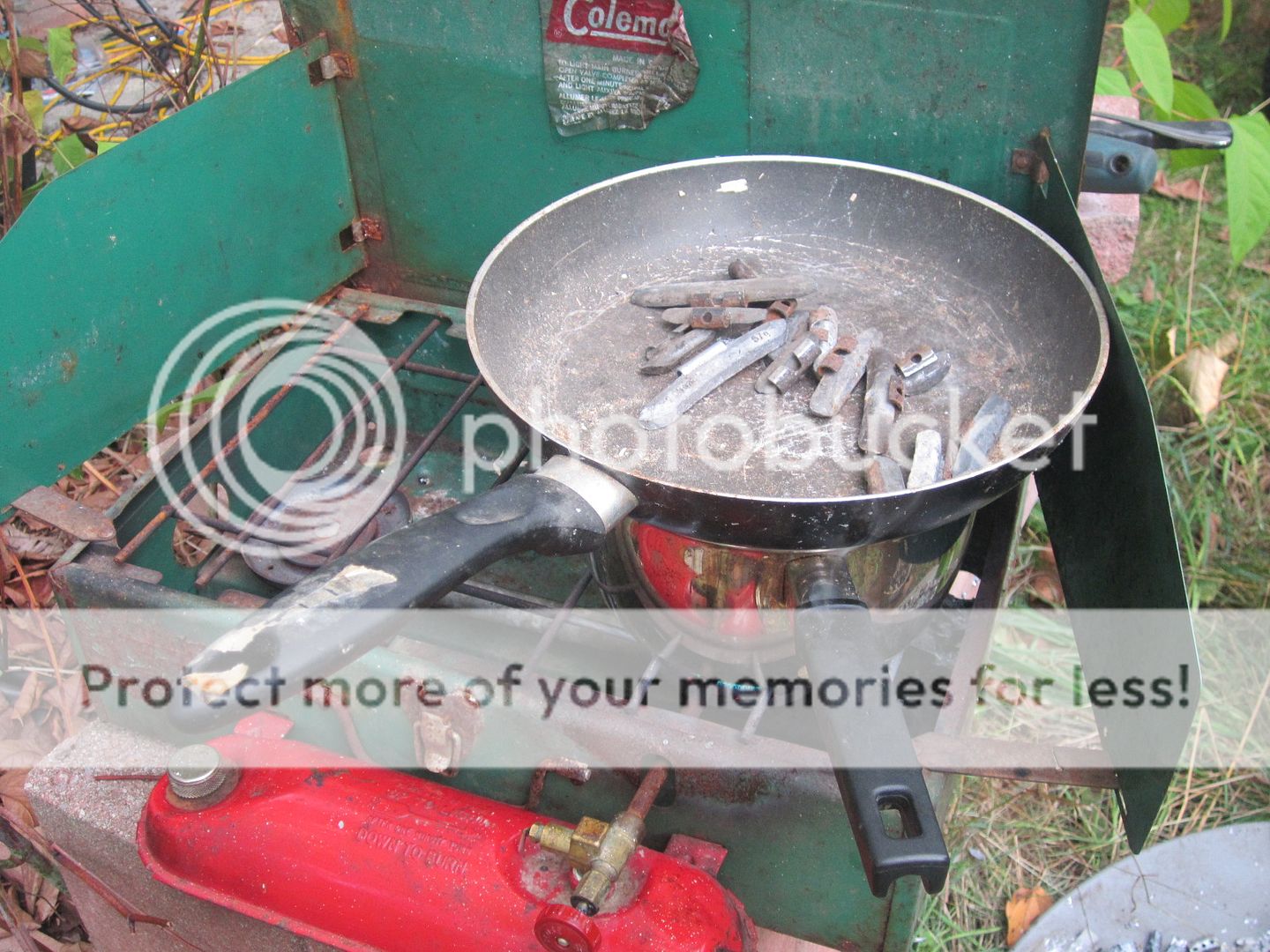

To each his own I guess. Never hear of melting zinc to harden lead. Everyone has his methods but personally I will never let zinc melt into alloy. I keep the melting temp below the Zn melting temp when I transform COWW into ingots.
If I want to harden lead I use linotype only.
