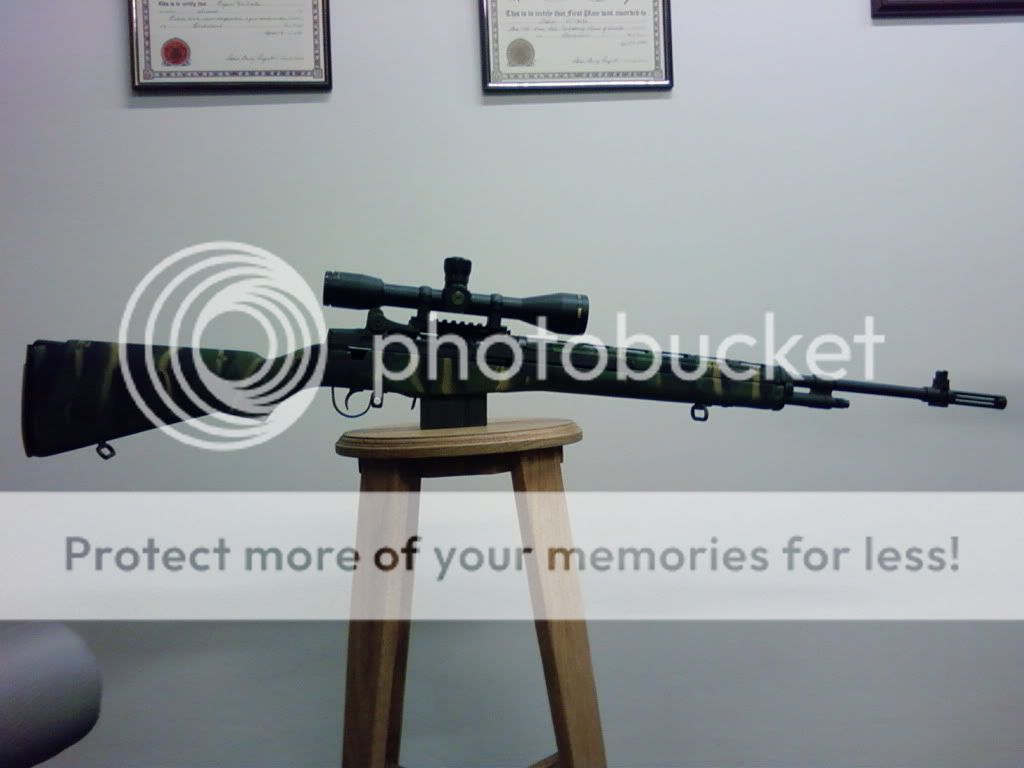

Heres what it looks like in the USGI stock and with the AIA 10 round mag. Still on my list of things to buy is a USGI spec recoil spring and op-rod spring guide.
