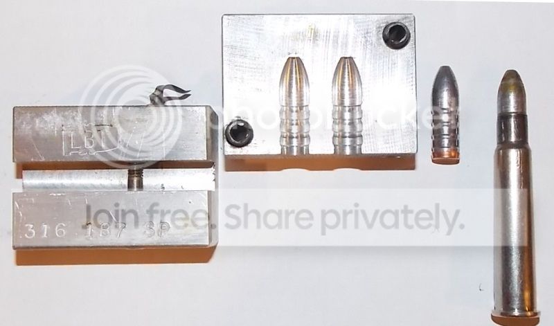

I have a few .316 NOE moulds, can you provide the Noe number for your NOE 316 187 SP?
I was wrong - it's an LBT (Lead Bullets Technology) 316 187 SP mold. Corrected.
Here's a pic:
