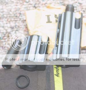

Pics
Here are the pics. It was imported specially from the U.S.
It was explained to me by the seller that it is a non removable barrel that Dan Wesson produced.
Yes, Dan Wesson produced fixed barrel revolvers but it was later on and probably not a Monson made DW. It was considered to be less costly to produce than the removeable barrel/shroud models and at the time DW company was looking for ways to boost the sales market.

When DW owners refer to the shroud, it means the barrel & shroud are interchangeable for differing lengths. The barrel is screwed into the reciever frame in the rear and up front secured with a barrel nut that fits flush into the muzzle end of the shroud.
One can change barrel lengths at will, (of course staying within prohib' or restricted category for the Canadian owner) with a special wrench for the barrel nut and this method also is believed to further enhance accuracy.
Barrel, shroud and barrel nut.

thank you so much for the input and the info. Should I decide to sell, I will certainly post here. I currently have the DW 44 kit but only have the 8 inch and 4 inch. This revolver is a lot lighter of course than the ones with the removeable barrels and shrouds.
What does this revolver weigh?
What is the length from the front of the revolver's frame, to the muzzle?
I would like to compare to the weight of my revolvers, with the same length barrel installed.
Thanks for posting good pictures depicting this interesting piece.:)
The barrel is exactly 5 inches from the end of the muzzle to the end of the barrel touching the cylinder. Weighs in at 2 3/4 lbs
