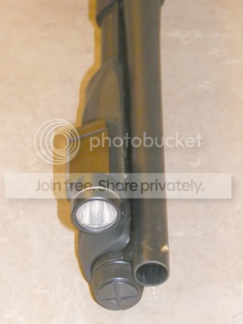

This is my setup, I think it works well, the light dosen't stick out past the barrel and the parts are good quality.

Streamlight TRL1
and a little piece of plastic pic rail.
Another bonus is the streamlight fits on my glock too.
That also looks really good. How about doing the same thing with a weaver scope base,and using a 1" or 30mm ring to hold the flashlight of your choice?
That's what I did to my Houge as well because I really like the houge foreend and wanted a light mount....the Fab is a pretty cheap option if you don't want to make your own.
I like it too cause the streamlight has its own mount built in and I can just pop it off and put it on the other guns without having to get a dedicated mount and then a flashlight. The light is friggen bright.

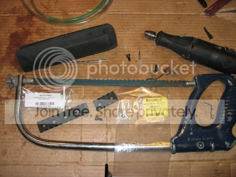

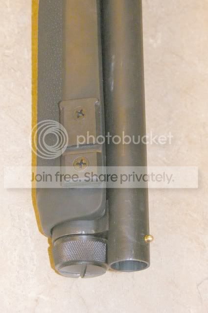

Can-down did you tap your screw holes into the forearm?
You can see the flat nuts and bolts in the first picture...I cut the flat nuts square and recessed them into the inside of the foreend with the dremmel (picture 4).
old skool bump, but can down it looks like you inlet the hogue forend for the nuts on the screws to sit flush. How did you do that?
All the tools I used are in this picture, on the dremmel I used a small cylindrical cutter and a larger cylindrical grinding stone.
